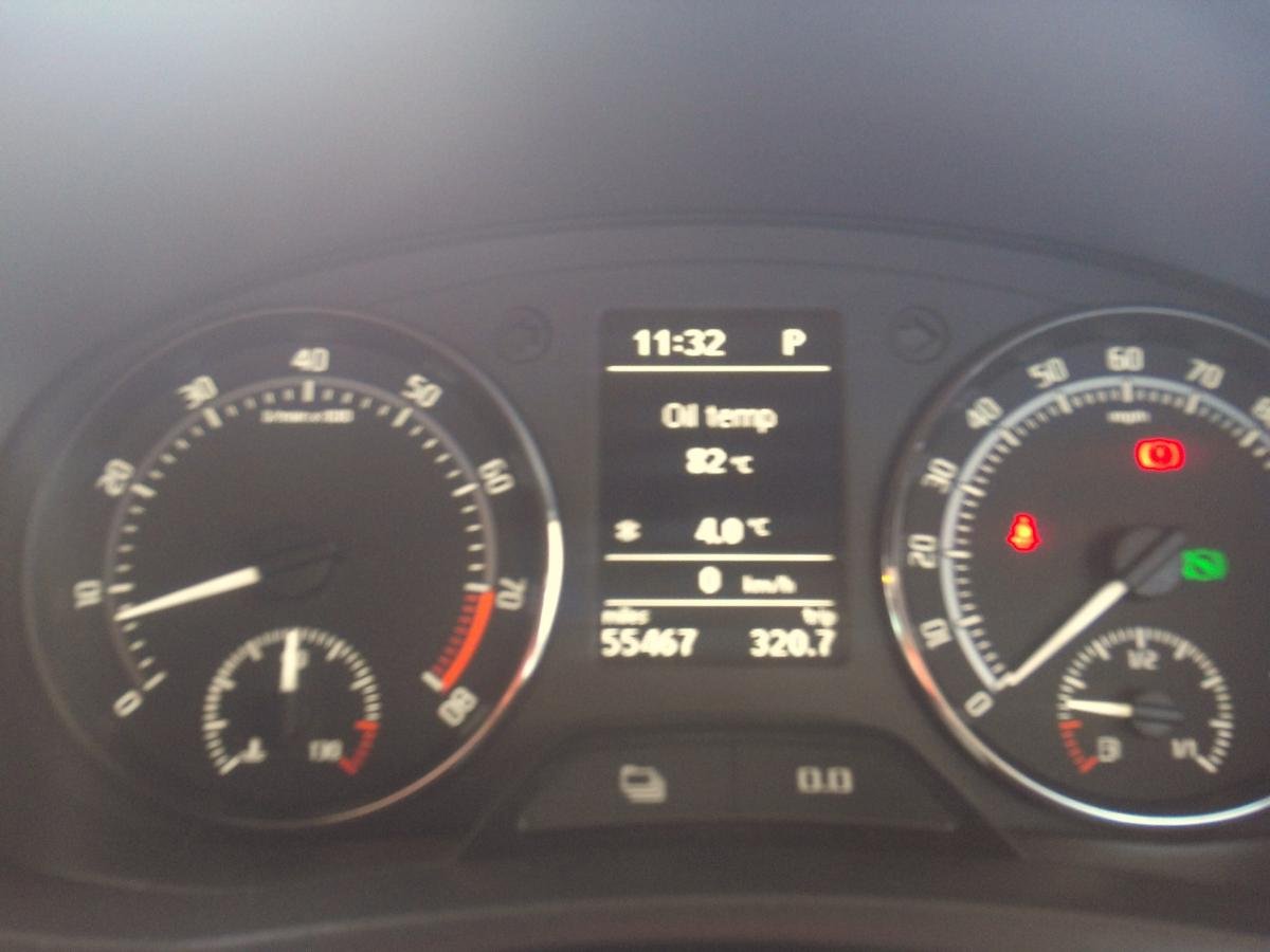

I have a skoda fabia vrs 2011 it is high mileage at 145,000 but well taken care of full service history car drives mint with no issues but recently when the oil temperature gets above 80° degrees the car stalls and shows the battery light on the dash when I let the engine cool down and drive it drives with no issues this only happend 2 or 3 times but was just wondering what could be the issue ? Thanks

Not so sure on the thermostat since you say when the Oil temp gets above 80*oC, not the Coolant temp which gets to 90*oC much sooner.
What is the coolant showing on the gauge>
So how do you get the Oil to cool down, it needs to get up to around 90*oC, which might be taking 10 miles or more.
It takes a long time for the oil to cool, and then it starts rising again to at least 92*oC & higher.

The Twinchargers can have the coolant indicating 90*oC in just a few minutes / miles of starting and setting off.
It can take 5 miles or more at 60 mph to get 50*oC indicated Oil temp,
and at low ambient temps, 15-20 miles to have the oil show between 80 & 90*oC.
There are lots of sensors and connectors,
and the connectors for the water pump and the ECU are prone to water ingress and corrosion.
