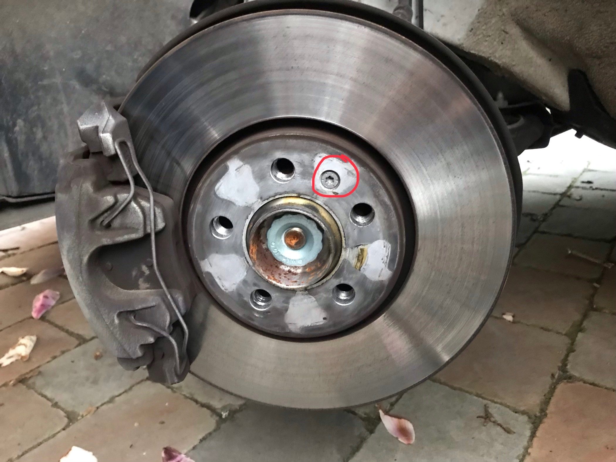

I was changing my wheel, after a puncture and noticed the 'rotor screw' (I think its called after much googling) was quite loose. I got out my torx set and gave it a fair tighten. Anyone else had this issue on Mk3 fabia 110PS? Is this likely to have caused any issues?
(please see attached photo for clarification)
It won’t have caused any issues, many cars don’t have the screw to hold the disc. The wheel bolts will secure the disc.
That being loose will not cause any issues, it is only there so that when you remove a wheel, the disc can not rotate and cause you trouble trying to refit the wheel's bolts and finding the holes covered.  My old 2000 VW Passat 4Motion did not have screws on its front discs, VW got round that by providing a hollow plastic threaded dowel that you fitted after removing the first wheel bolt and removed after replacing the first 4 wheel bolts.

Use a bit of thread lock to stop it coming loose and also prevents it seizing when you come to remove it.
