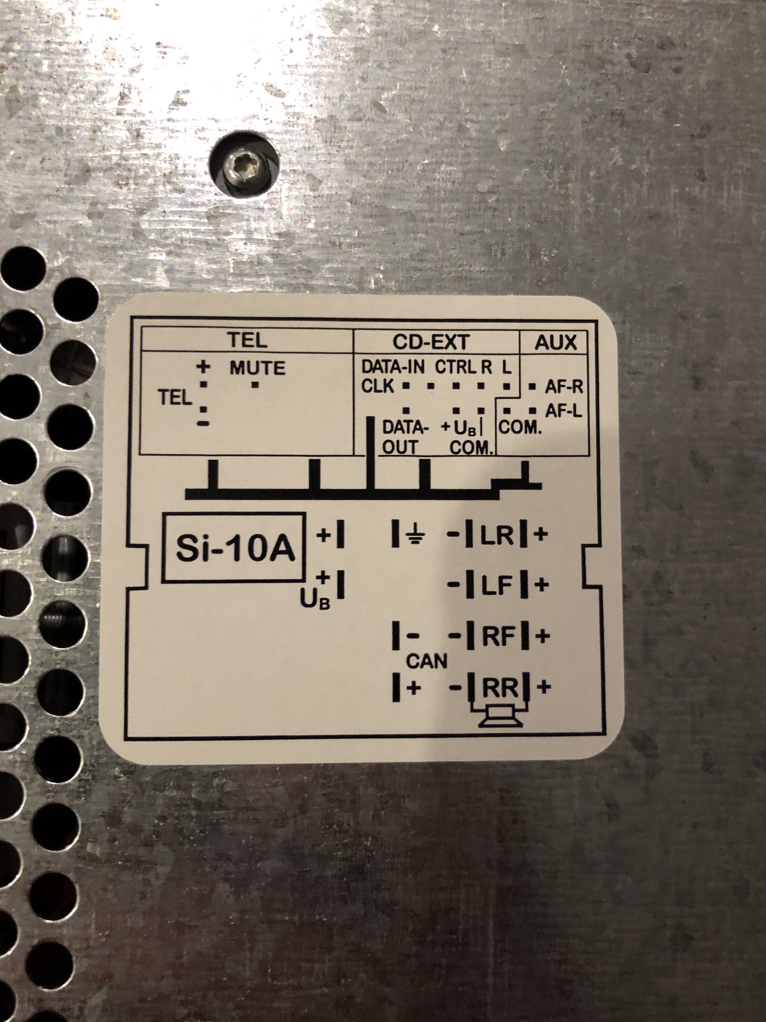

I've put a picture of the wiring diagram for the in car connector taken from the Dance. Where should I have connected the ignition cable on the pioneer loom. I have it connected to the +UB currently. Maybe this is where I am wrong?

The original Skoda headunit didn't have a switched live, instead it will have turned on/off due to a can-bus message.
You either need to run a switched live from the fuse box or buy a can decoder to give you a switched live.

ok thanks, are you able to suggest some products that would enable this? and then where would they connect to the stereo?
cheers
There are plenty of versions but this is an example of a CAN decoder: http://www.connects2.co.uk/Product/ProductItem/CTHUE-SK1
There are installation instruction in the 'Downloads' section but in this case, it gives you a standard ISO connector with a switched live already present so should be super easy to fit :)

ok great, i will get hold of one of those
ive got this ISO, will the CAN be able to fit somewhere in the loop or do i need an ISO with the CAN?
