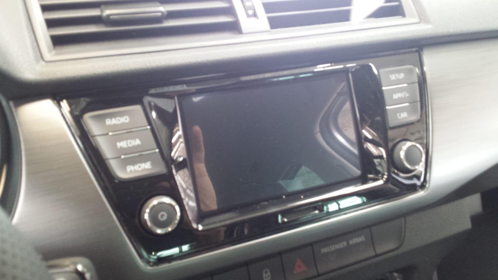

hi i bought a new skoda fabia 2019 and in dosnt  have a rear view camera the dealer what a 330$ for aftermarket camera .
i thought that i buy my self aftermarket camera and install it by my self with coding like i did in my 2016 octavia but in the new fabia it have different radio and i cant find same one how did it i heard it dont have codeing at all some one know how or if i can install it by my self ?1775542259_WhatsAppImage2019-05-01at10_46_28.thumb.jpeg.ec4fc9ab2abd48a99554cd82620b888d.jpeg
That's a Swing radio, presumably a Swing Plus as it has an Apps button? No idea how to add the camera I'm afraid but there are certainly Swing Plus radios that can show a backup camera.
Swing support rear view only with index E on the part number.

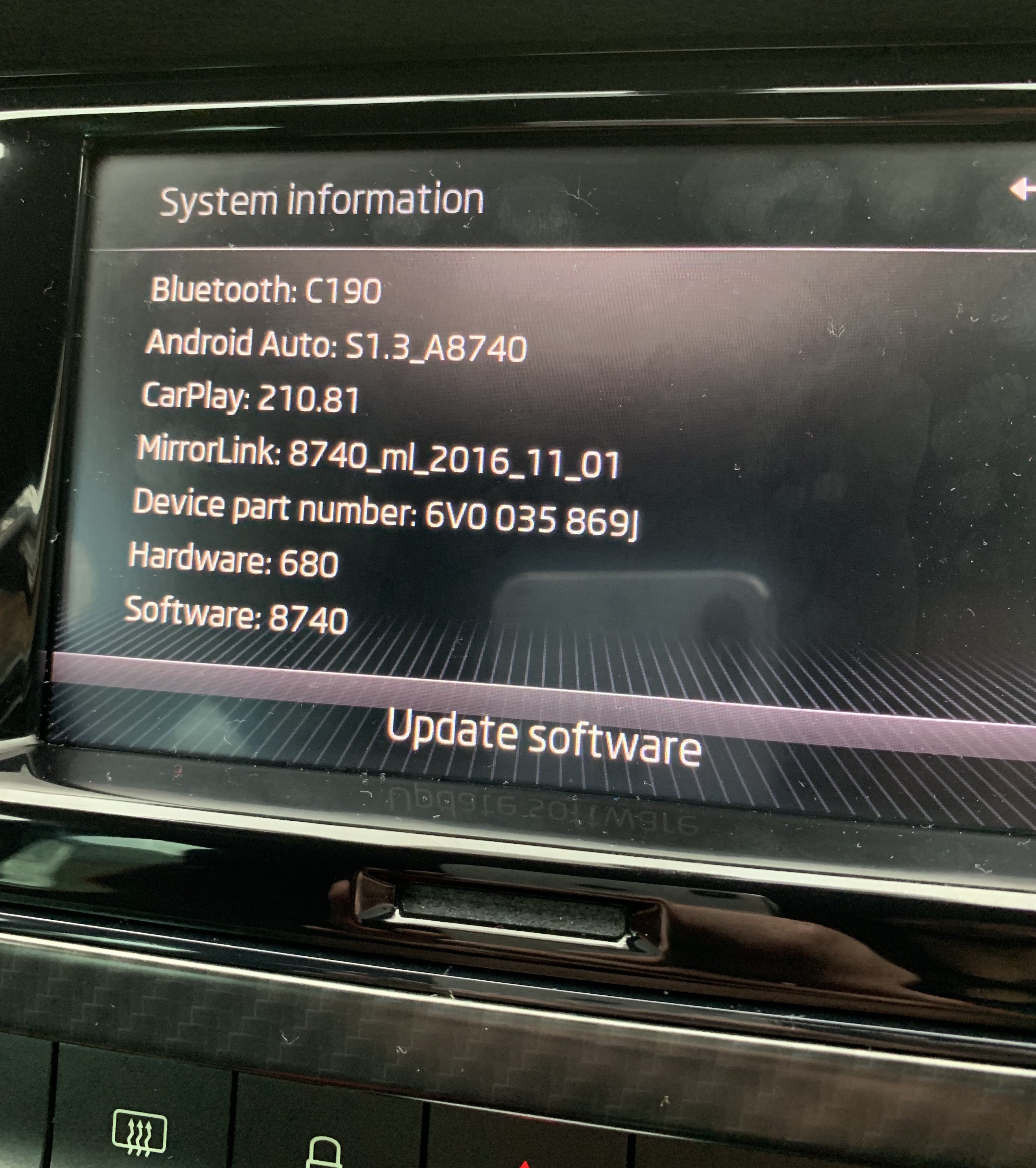

try the number via SETUp-Information-About (?)
Should be possible mine has a camera same swing plus.
i have an h index :sad:
With Camera
sorry, I was wrong write it. it should be E or higher. I personally did not verify it. I only have it written this way
