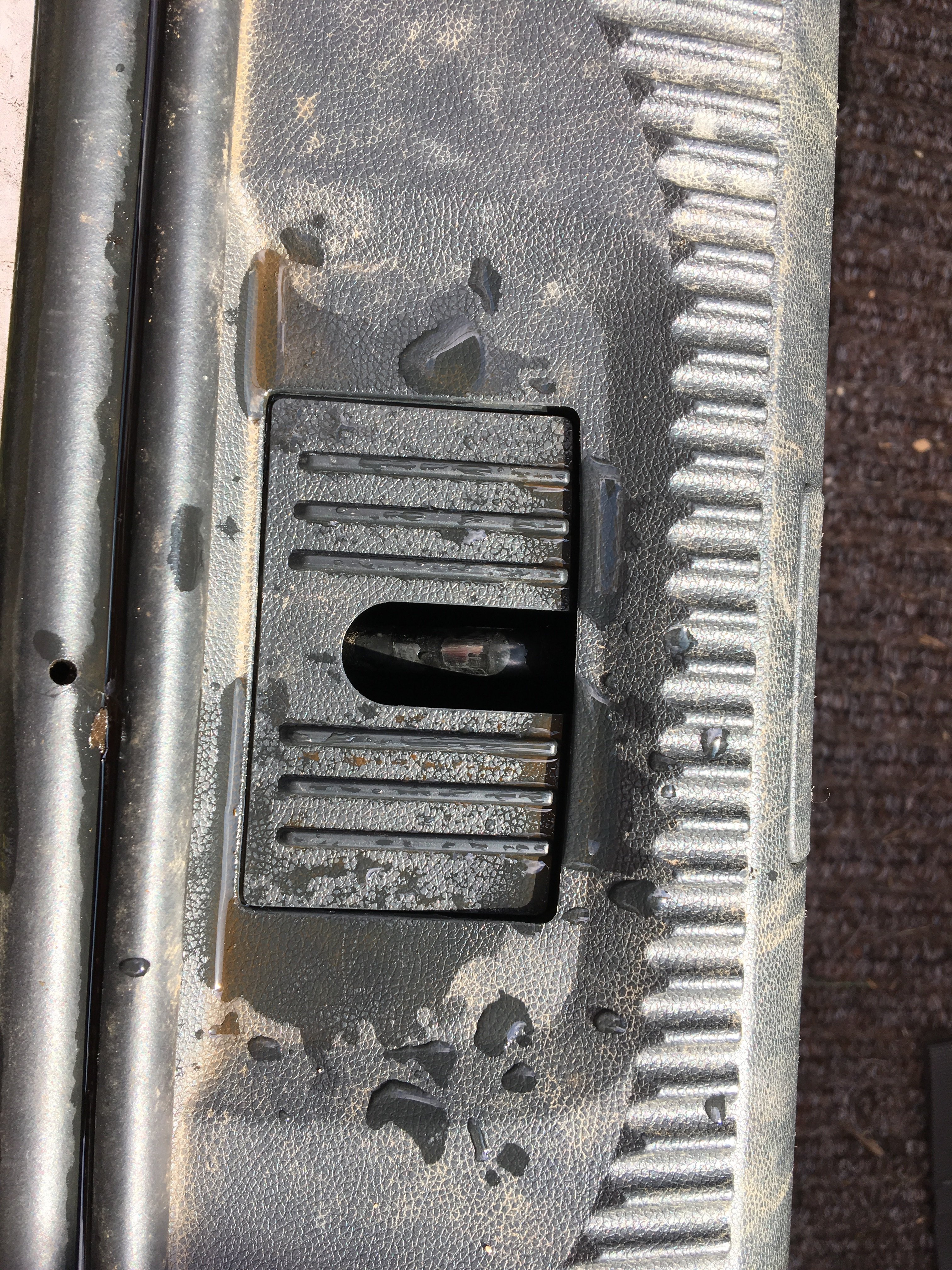

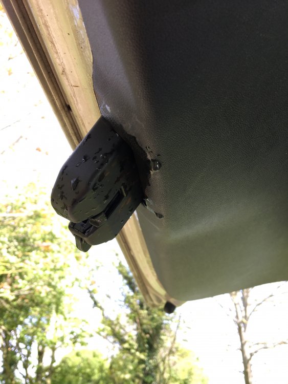

The rear wiper on my Octavia hatchback has just stopped. It did this before and I sprayed some lubricant on it and left it overnight and it has worked ever since. My rear washer has always played up. Water comes out of the wiper area outside of the car, but the jet always seems to be broken, so the fluid leaks around the outer housing of the wiper motor outside the car and also seems to leak down through the boot latch.
The motor sometimes works now, so I'm not sure what avenue to go down to fix it!
Any ideas?

Yes I had a same issue. Basically you will need to replace jet as old one will be full of rust and check the connection between plastic housing on the motor and pipe. To check connection you will need to remove plastic door cover witch hold by one screw on boot handle and just unclip with force.  If you experiencing problem with motor, it's because the washing liquid is leaking into the motor as the fluid is going throw motor wiper screen pinion.
