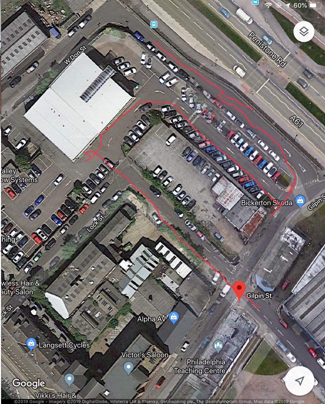

A90F2F1F-69FA-4136-8B31-644F5C89F2B4.thumb.jpeg.6ca722655b4e2c8da98f038ac602fc58.jpegUnfortunately there is nowhere to park my outfit. If I got it into the dealership I could not get out again without bringing the van out on its own. The car transporter parks outside on the road & the cars are driven in one at a time.The layout of the dealership makes it impossible to drive a car & caravan combination in together.
