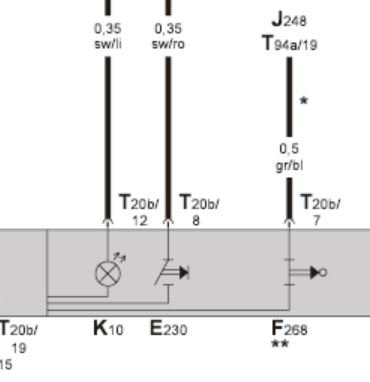

Hey all, Done the FL panel retrofit in my PFL, following the guide on here.
All is fine but I've lost the function of my heated rear screen?
Anyone had similar behaviour? Looking at the wiring between the PFL and FL the wires are in the same place 🤔
T20b being the large 20wy black connector
K10 the Heated screen lamp
E230 the switch
Identical pinout from my 08PFL and a 2010FL... :wall:
