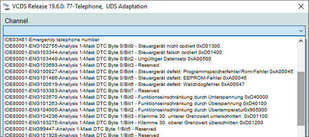

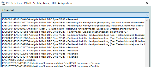

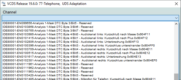

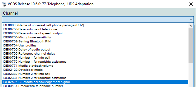

The wife's new Yeti has the annoying bluetooth bong on startup. I've been in with VCDS to try and stop it and can't find the welcome bong that other people refer to. Here is what I see:
731724735_2019-06-07(2).png.7a43943d8246ed2077699adcb463f7f7.png593202998_2019-06-07(3).png.fcb837bf86a9bf40bd333ef72a60bd7a.png929992372_2019-06-07(4).png.60cd7a2ffea3873976cb4a802133fc37.png
Is it the bluetooth acknowledgement that I need to change?
Thanks
Anyone?
To answer my own question for someone elses future reference it is the Bluetooth Acknowledgement Bong (IDE250-4)
