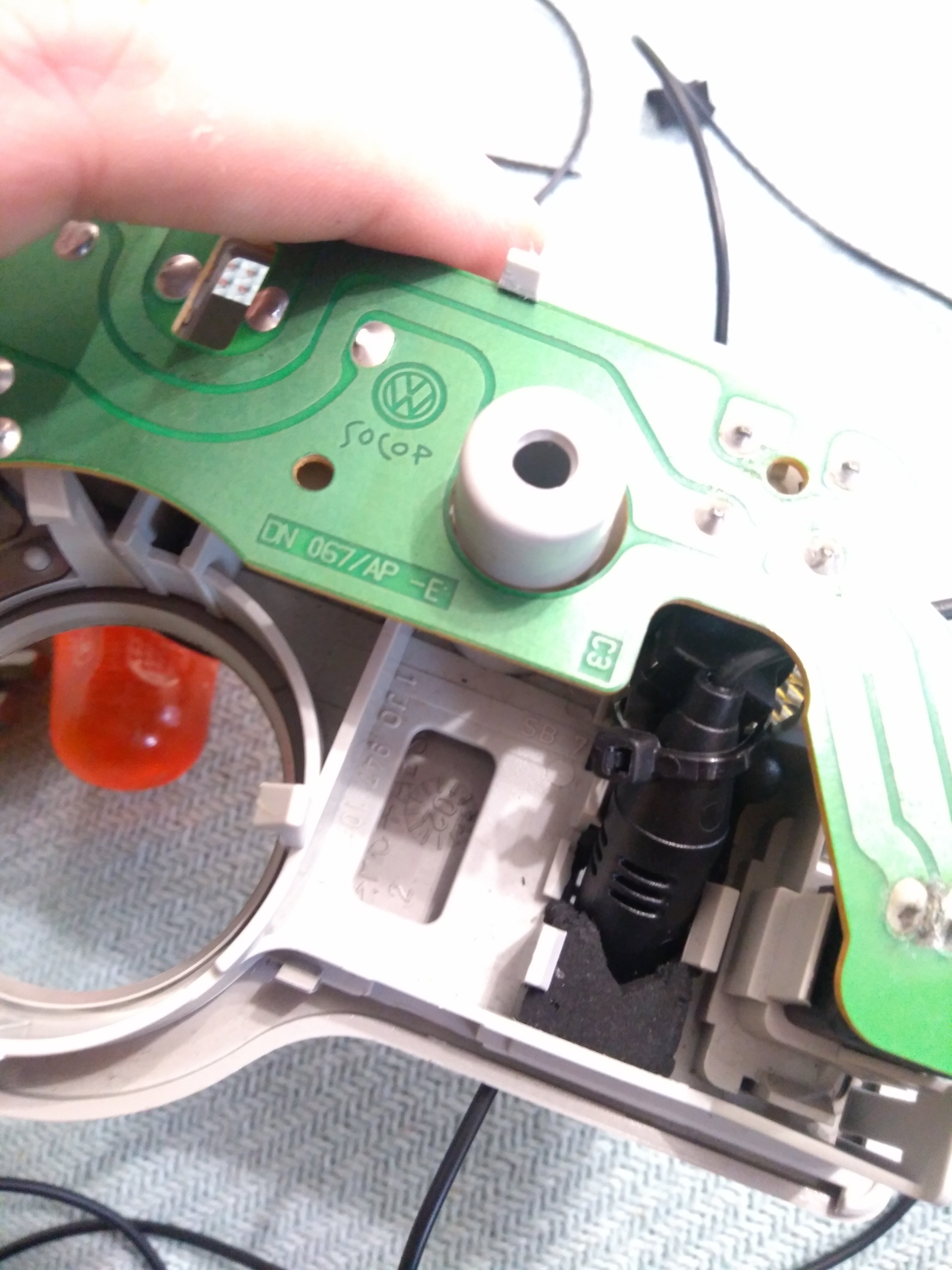

Installing a Pioneer double din with Bluetooth. Is this position where the OE mic goes in the courtesy light/sunroof switch likely to work ok? (Assuming I have enough cable length).
Edited by anewman
Gave it a go and people on the phone can hear me fine, and Google voice commands work ok.
