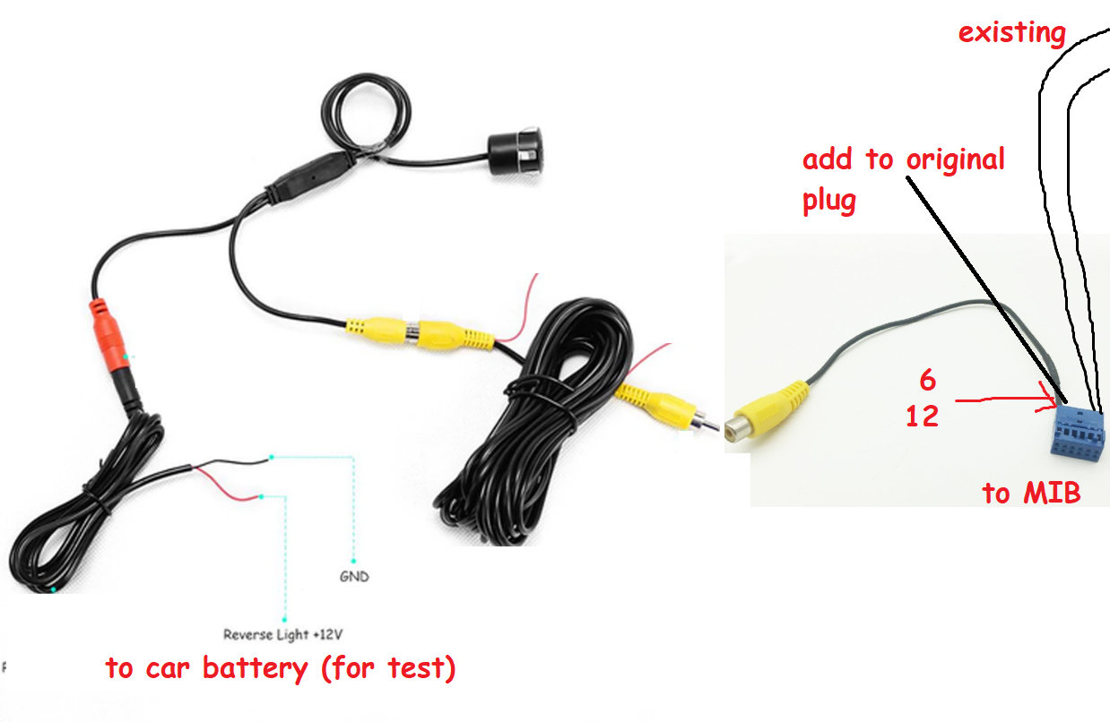

My skoda is 2014 y with MIB1 (with BT....)...  I bought cheap rear camera and MIB Adapter (I connect to port 6 and 12).

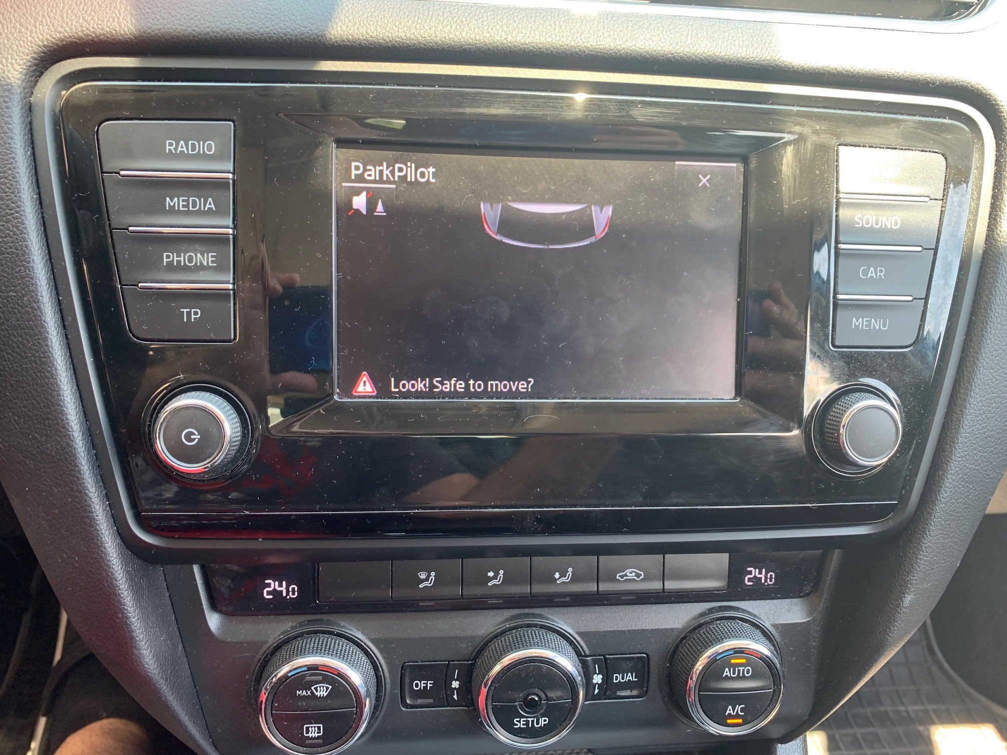

I now have a just same screen picture like before (see attechemnt). Parks sensor work fine, but I need display graphic for camera. Any ideas?

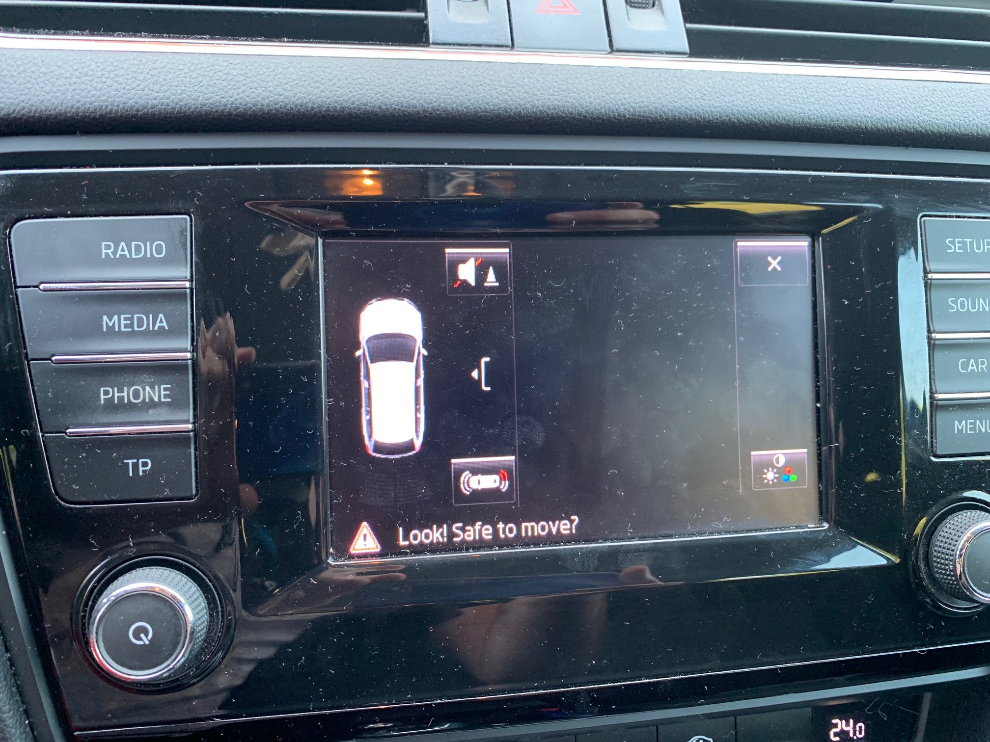

Menu is work now, but no picture 😪
These cheap adapters are often more trouble then they are worth. Check the power connections are good, where have you powered the camera from?

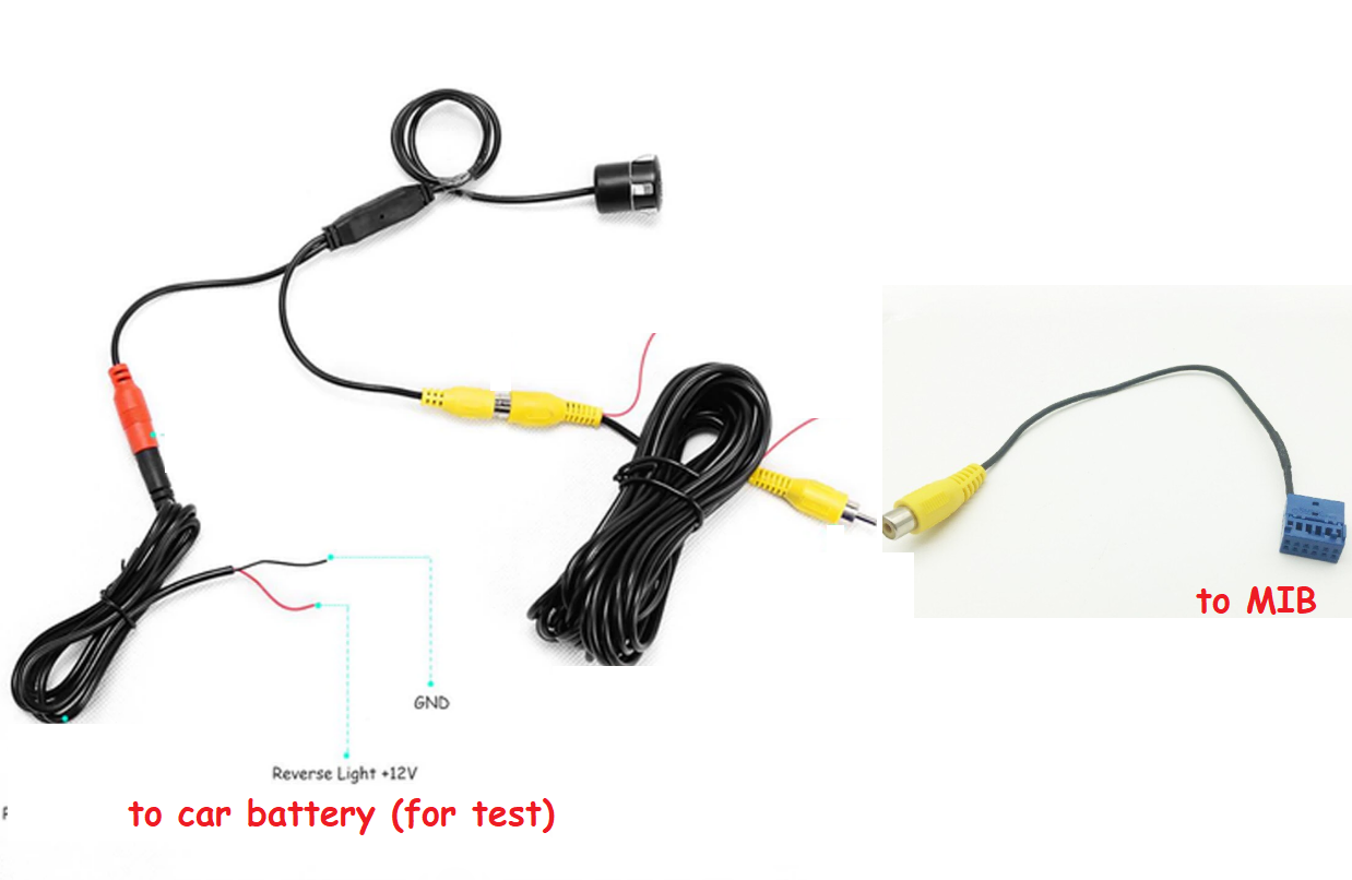

I connected camera directly to MIB (video cable) Need adapter? Which one?
Just for test, connected cam to car battery ( + and - direct) ...

I want test and connect:
I didn’t change the little blue quadlock connection on my install, I pinned the loom and plugged that into the blue quadlock on the car.
Just noticed you have a TP button not a voice button, pretty sure you need it to be BT and Voice unit for this to work. I guess you have the microphone wires in Pins 1 and 7 of the blue quadlock?
I didn+t change, too, but add pinn to port 6 and 12 on exsisting adapter.
Yes, 1 and 7 is also conencted... What now?

Maybe your headunit needs restarting. Press and hold the POWER button until the Skoda logo appears again (cca. 15 secs).
And there's no picture if the boot is open.
Possible PAL / NTSC problem?

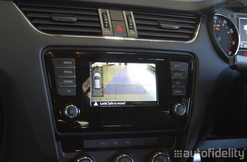

I found this picture on net... hm...
Could be an aftermarket module, the car in the pic doesn’t look like my OEM one does. Also people have hooked up modules to make the FL Swing radio’s take cameras and they don’t as standard. If you go MIB2 it’ll work :)
