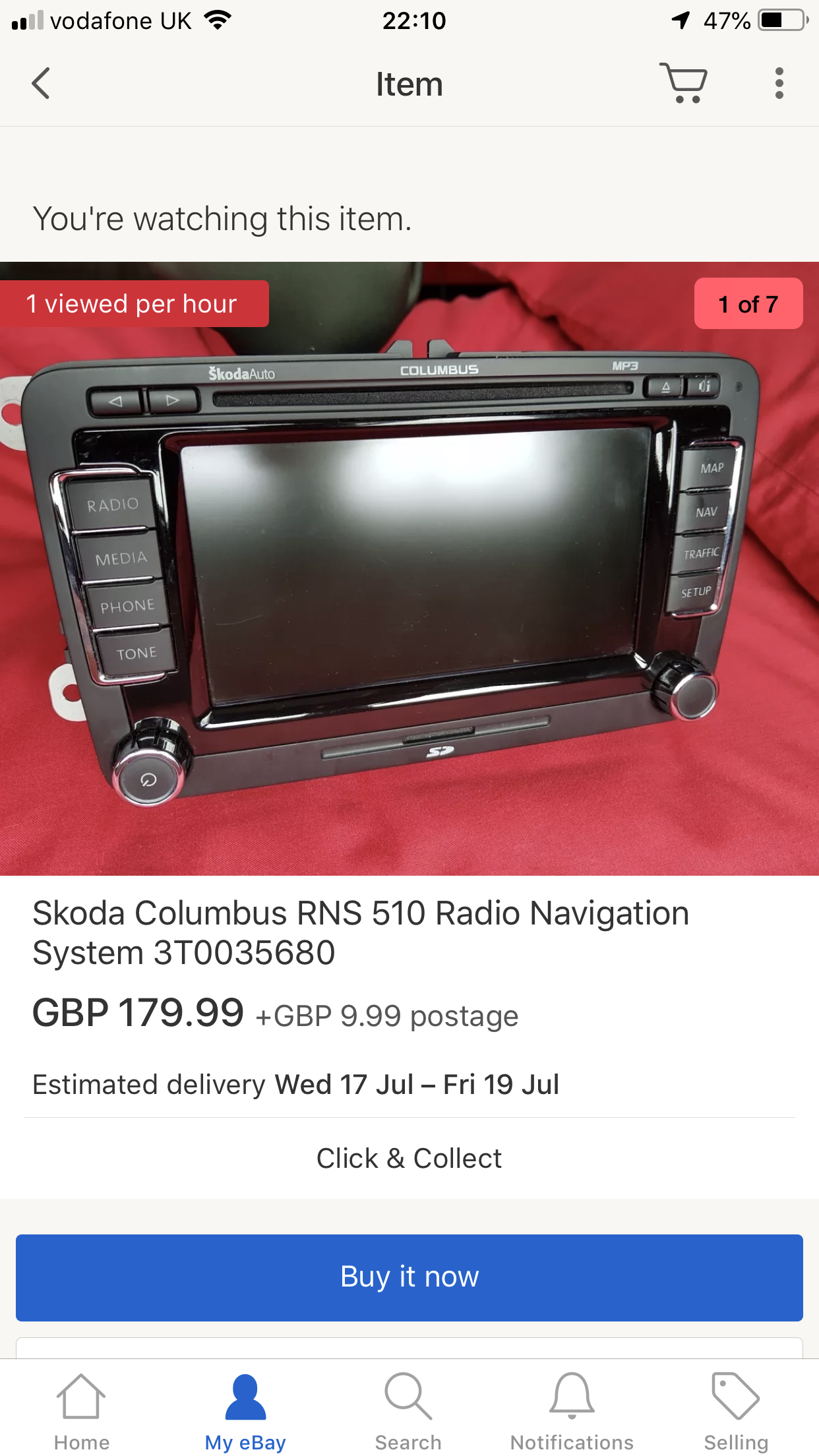

Has anyone removed a standard (2.0 diesel 2006/7) VRS stereo and upgraded to a Columbus Sat Nav unit ? What did it cost you and any issues ? Something like the attached pic below.

You'll have some issues with full functionality on a car that age. Battery drain issues, parking sensor issues, steering wheel controls issues for example. Also, that unit in the pic is very old and one of the earlier units which are known to fail fairly drastically.
I'd be looking for a newer one if it were me, but that would still leave you with the issues outlined above.
