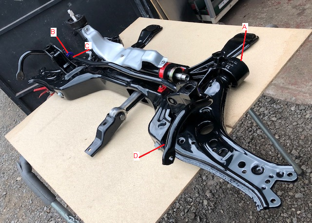

I'd budget for all the extras too like top mounts and bearings, anti roll bar drop links and give all the bushes a good look over too.
Things worth checking
  • A - Console bushes
  • B - Anti roll bar bushes
  • C - Anti roll bar locating collars
  • D - Wishbone bushes
