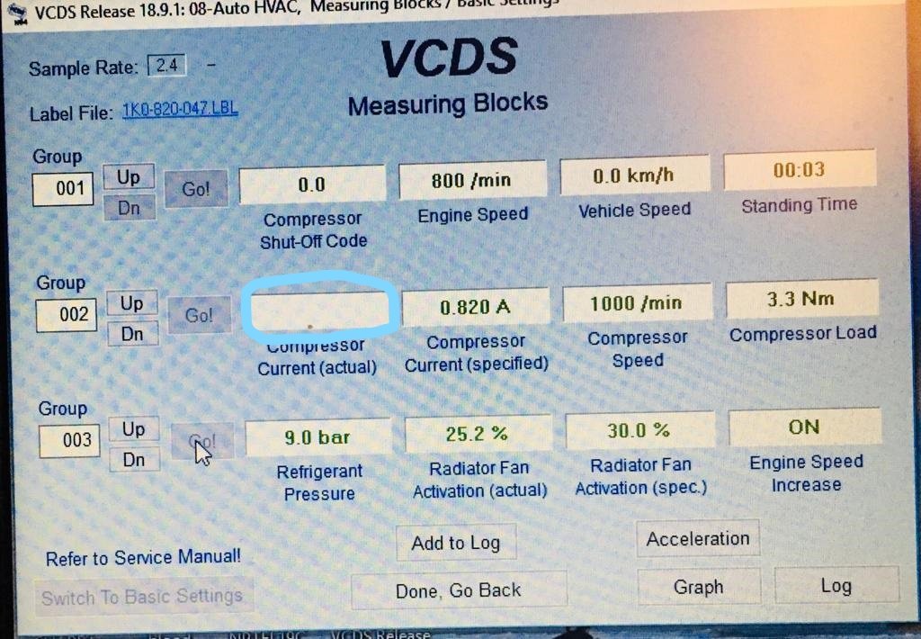

I so have a similar issue .. 😞 aircon is not working and blowing hot air.. when i checked with VCDS i got the following .. don't know what could be the issue as the "compressor current (actual) is not having any value at all !
