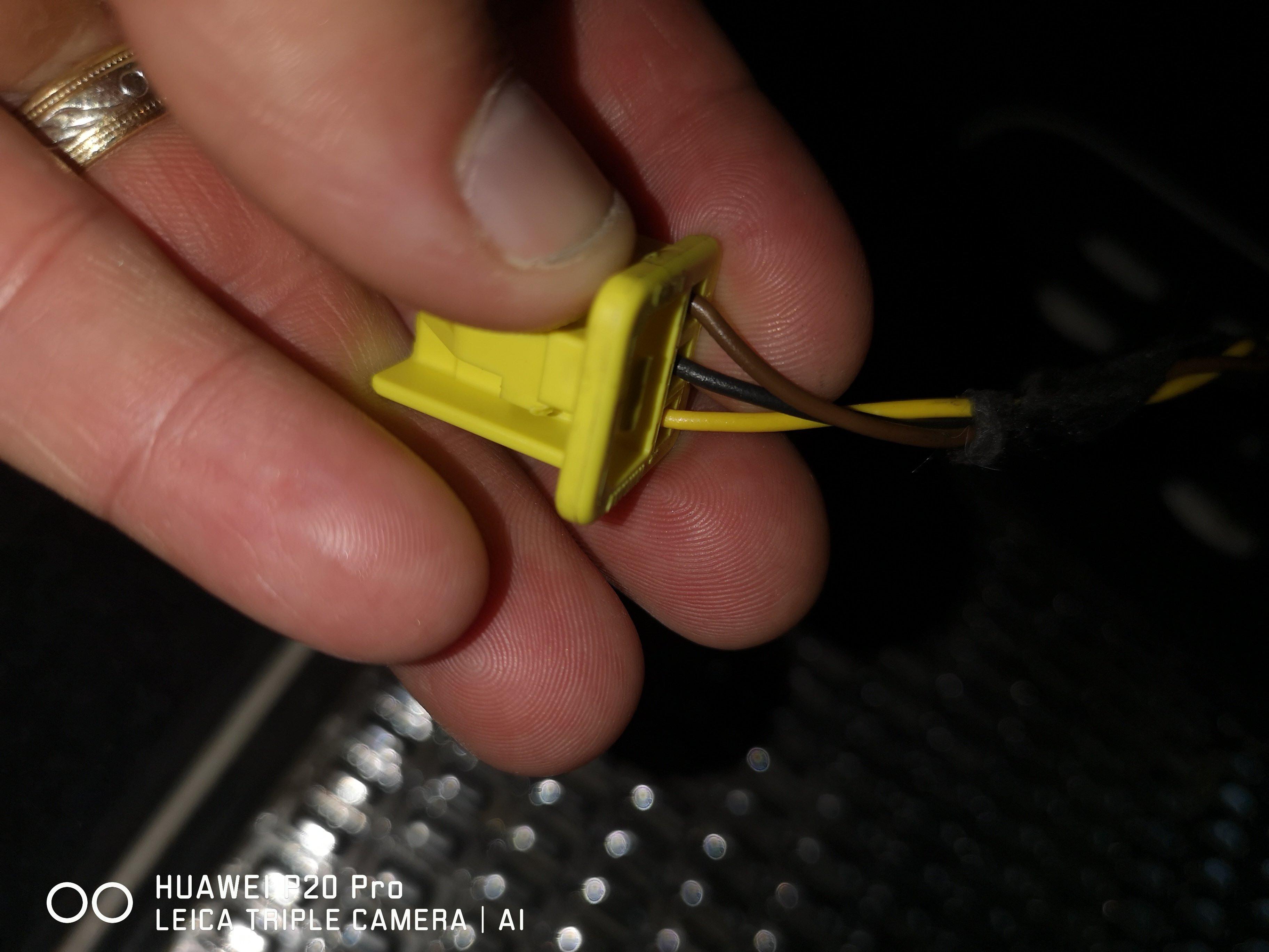

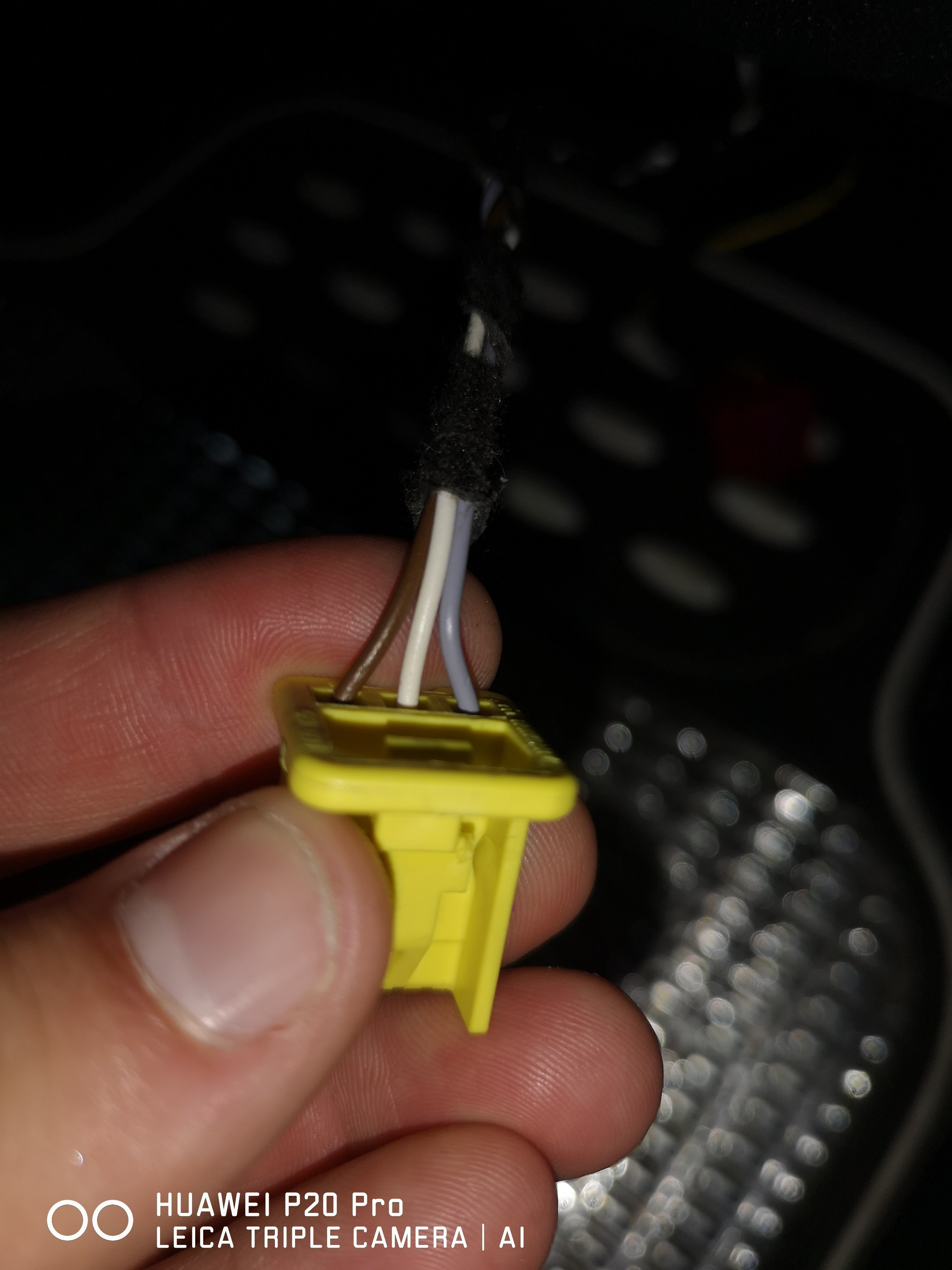

Hello I'm after some advice My wife had a mk1 vrs fabia which has been written off so I decided to take out the seats and fit them to my mk2 fabia. All went perfectly well until I couldn't plug the connection in so the airbag light has come on. I've included pictures I'm wondering is there some way to modify the wiring or plug something in etc to make the light go out before it's mot.

I take it the MK1 Fabia didn’t have side airbags then?
No it didn't no which I've only just found out today
You will need a resistor then to put in each plug to fool the airbag ECU into thinking the bags are there and then the codes clearing.
That sounds good I may go to a car tech place see what they charge for this. Shame there's nothing I can just plug in my friend was on about cutting the wires and jointing them but with 3 wires it sounds like if I judge wrong it could open a whole can of worms.
Really appreciate your advice I've took a screenshot so I'll ask about having this done. Thanks again
You can’t just cut the wires as it is expecting to see a resistance of an airbag.
Makes sense to me thanks again
