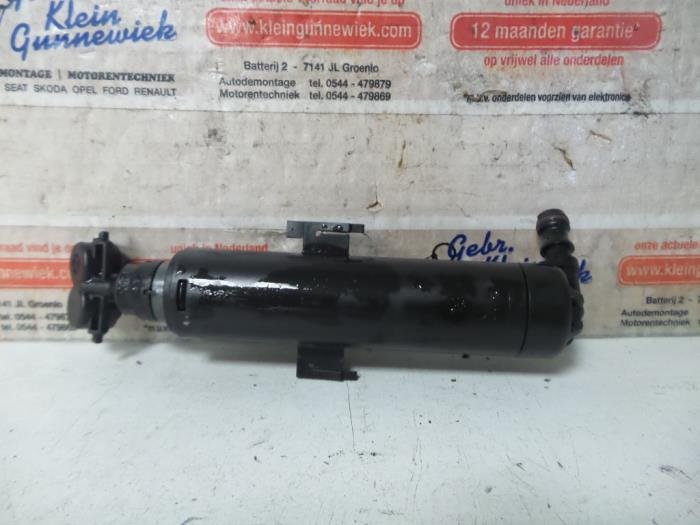

The headlight washers can leak. The driver's side has more room to reach down and have a feel if it feels wet at all.
It's clipped into a plastic housing so you will only really see the tail and the rubber pipe is secured with a blue clip.
