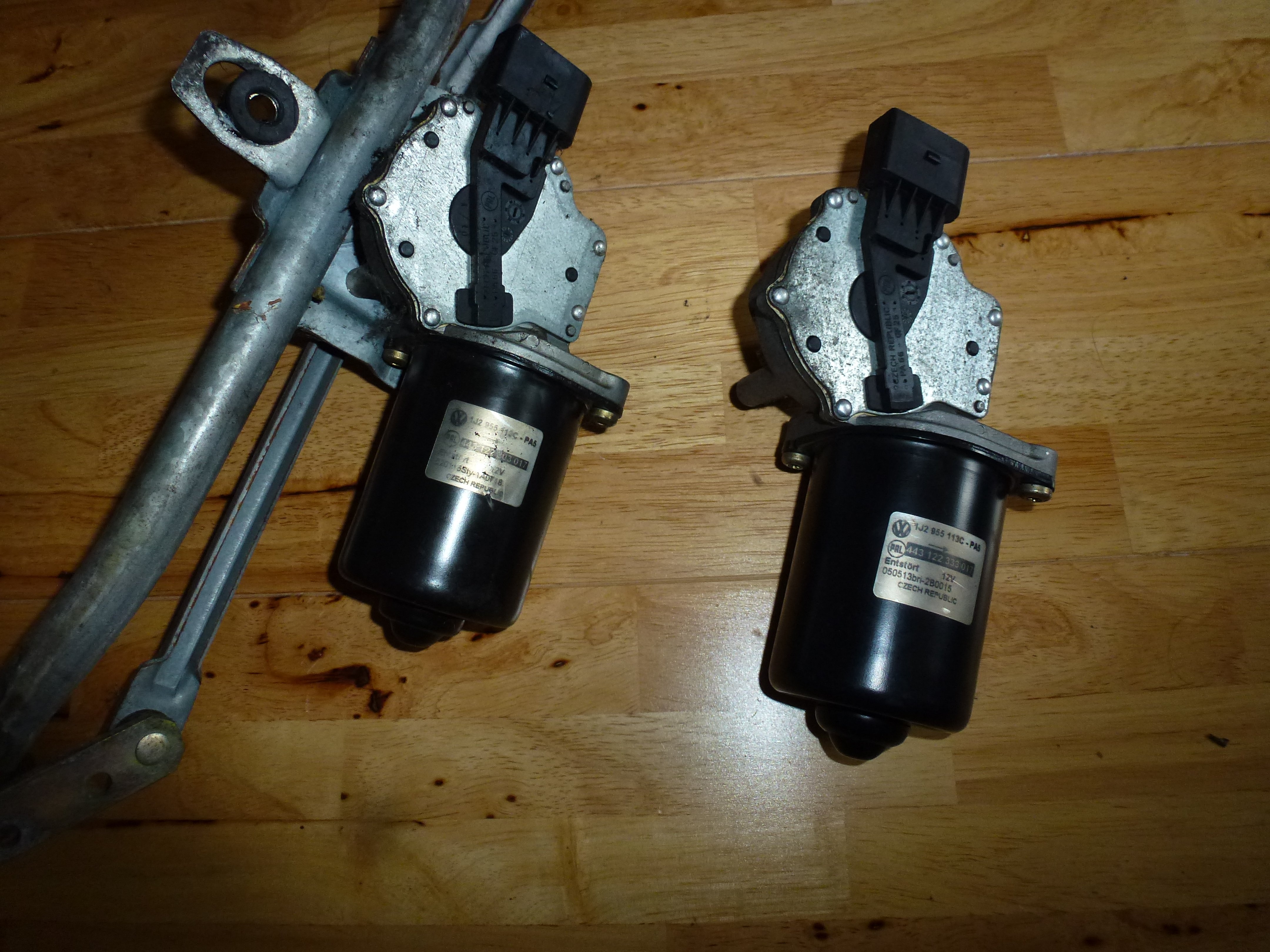

OK - got the motor and linkage out and separated the motor from linkage arms.  Linkage on its own seems to move freely from side to side with very little effort from me.
I'm unable to rotate the spindle on the motor however, unless I try quite hard with a spanner on spindle nut..........seized motor then?   Is there an easy way to test it linking up directly to a 12v battery or some other way?
***EDIT - Brief update - reattached motor only to its electrical connector and ran an earth wire from one of the motor mounting bolt holes to the frame and checked for continuity electrical between the two points......flicked wiper switch on but still no activity at motor.  No noises, no movement.
Washer jets function fine so thinking switch is fine and motor is dud.  Anything else I can check?

Sorted for now - swapped the motor from my 2002 TDI, which is identical part number in my case, and all is good once again.
