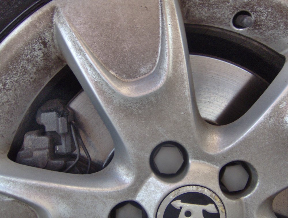

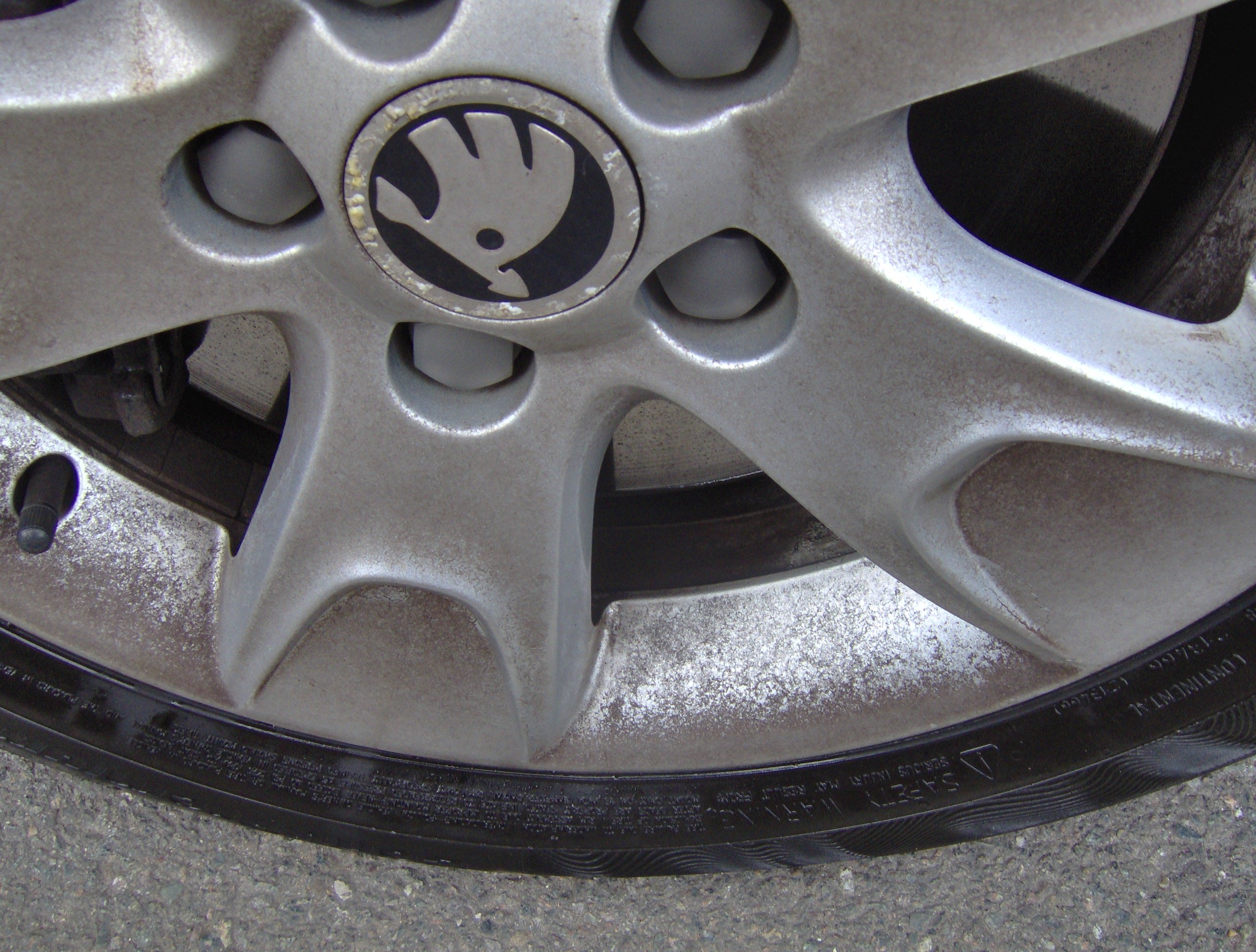

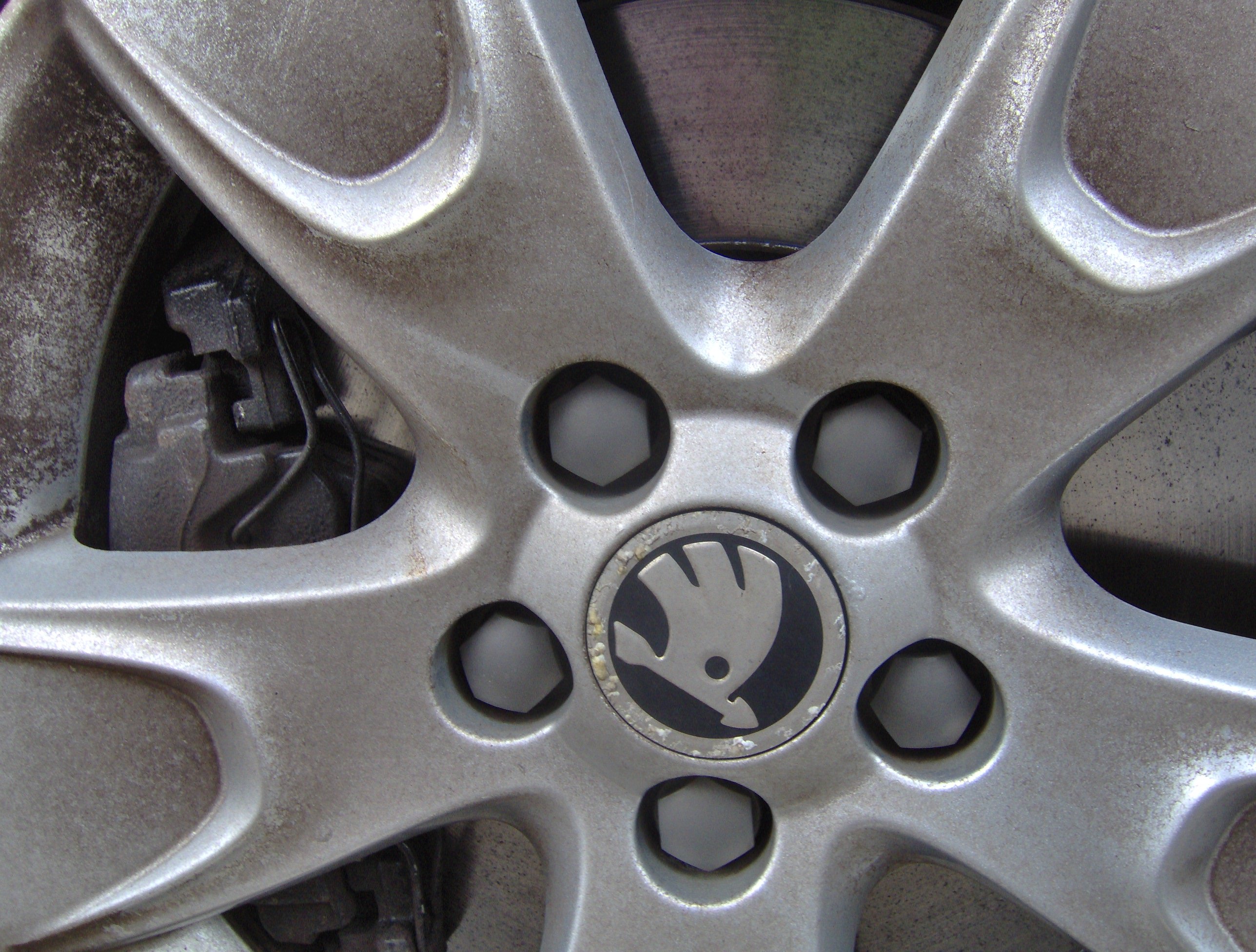

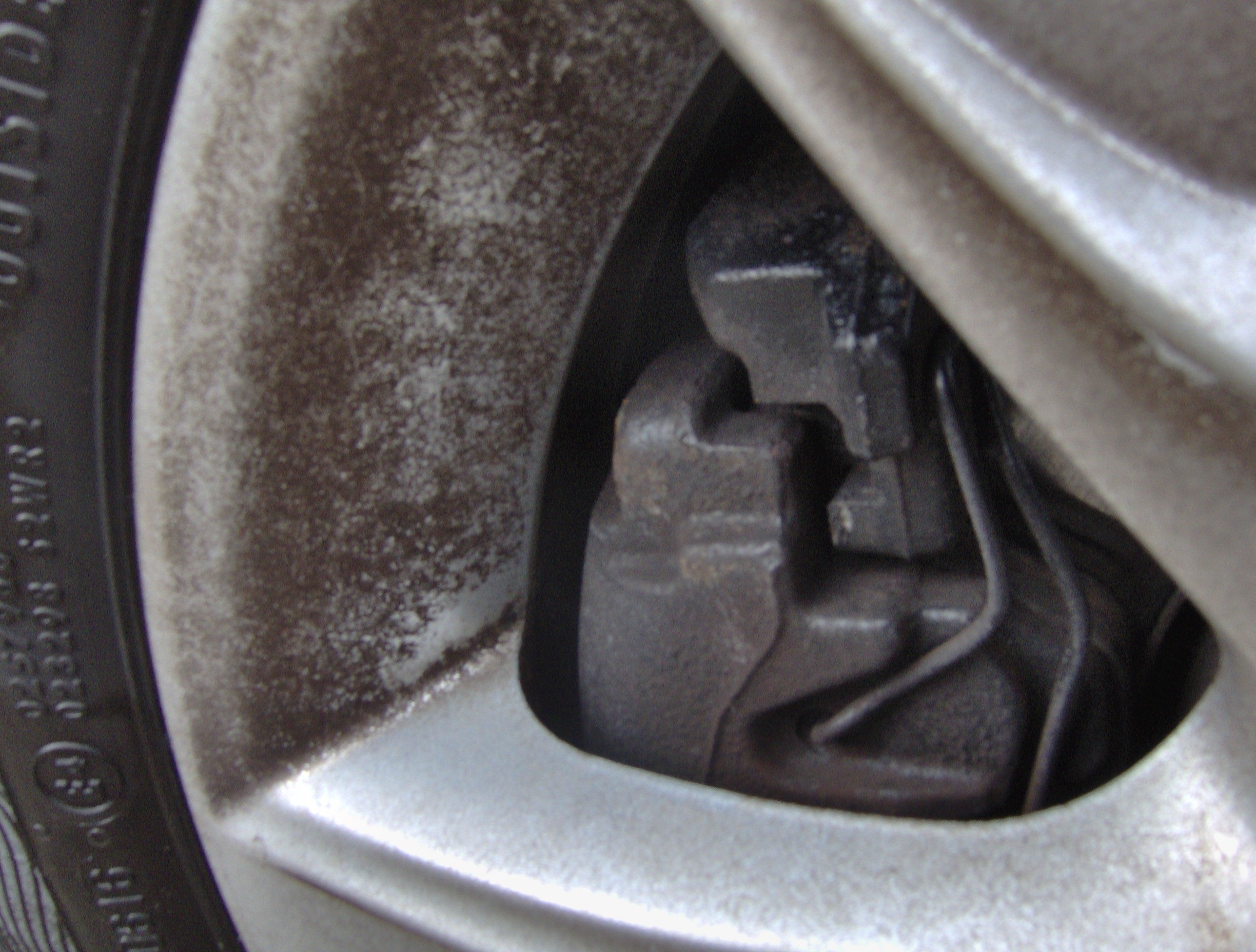

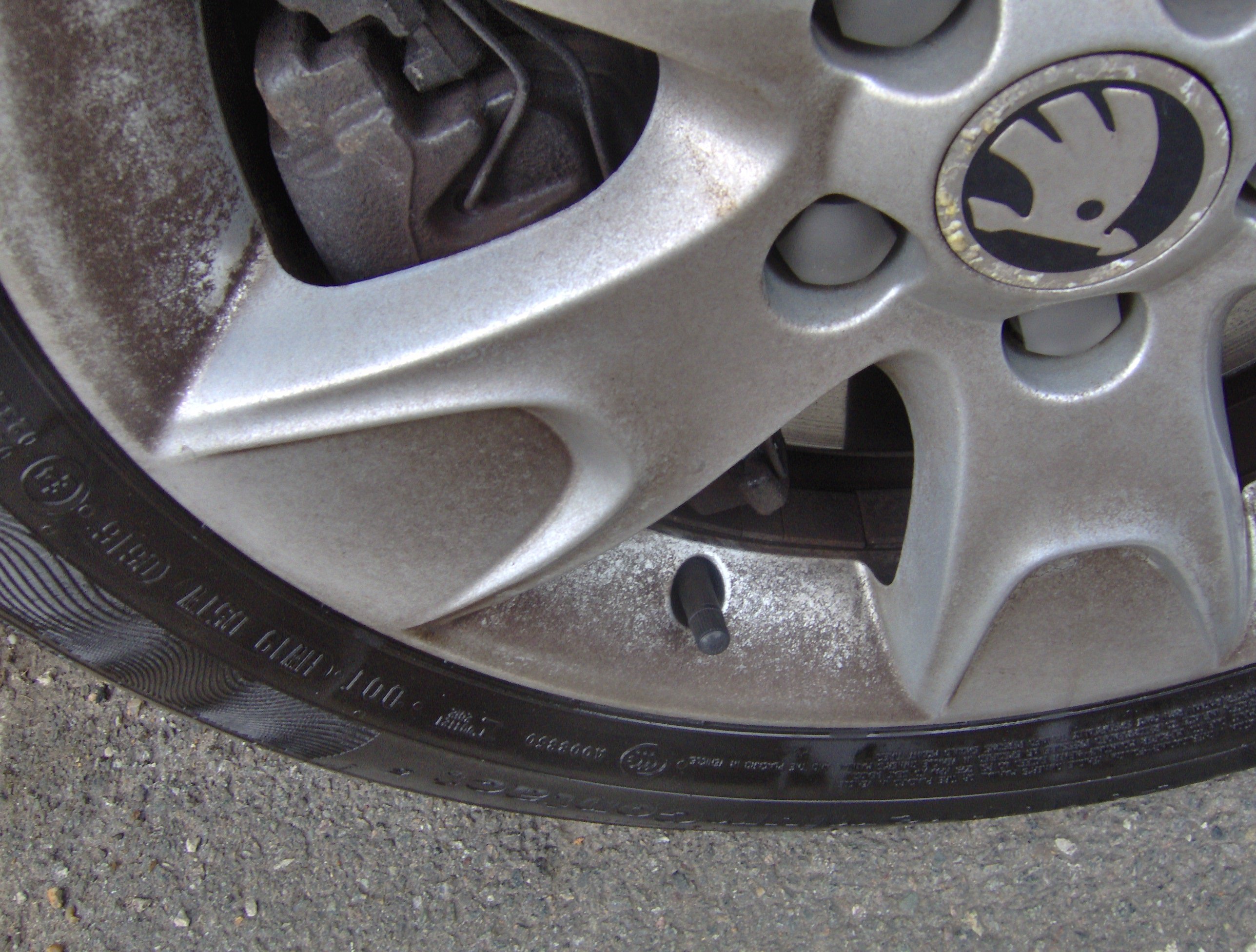

Thank you for the quick
I have taken some photos which might help to identify what the problem isHPIM0020.thumb.JPG.d063efabf199c3b45853a50104be9467.JPGHPIM0022.thumb.JPG.2e1ac2cc5b51a384553a93ff8946ab66.JPGHPIM0023.thumb.JPG.7216b36ba02f5eca2c4f171b5ecad0d0.JPGHPIM0020.thumb.JPG.d063efabf199c3b45853a50104be9467.JPGHPIM0020.thumb.JPG.d063efabf199c3b45853a50104be9467.JPGHPIM0025.thumb.JPG.103ac2adea5ff5cf2fcb1fb87f67d6e1.JPGHPIM0024.thumb.JPG.eee21d83cb6d698f5eec0937ee4bd040.JPGHPIM0024.thumb.JPG.eee21d83cb6d698f5eec0937ee4bd040.JPG
Ah, that's general speckling. The most likely cause is the powder coat failing.
Baked on brake dust and iron filings. Gone too long.  How does a valleter not know that?
Thank you to all who read and replied to my post. I have read them all and settled on baked on brake dust. I purchased an oddly named product from WILCO car accessories shop ;
Dodo Juice Ferrous Dueller Wheel Cleaner Spray 500ml
I tried it to day on a small area that was really thick...................... and it works.
