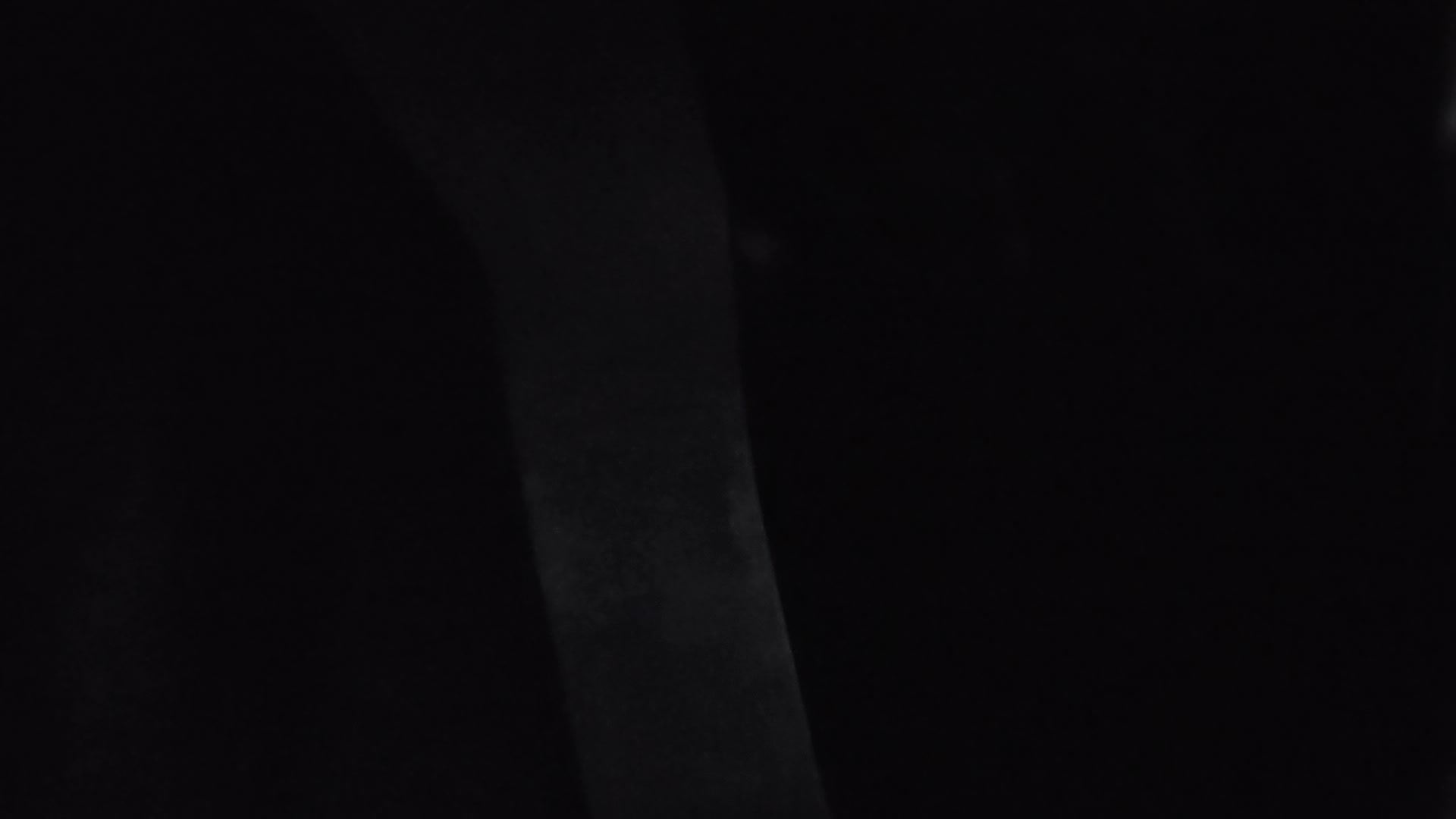

Hello again.
I now have a video in which you can clearly hear the sound, what could it be possibly be ?
