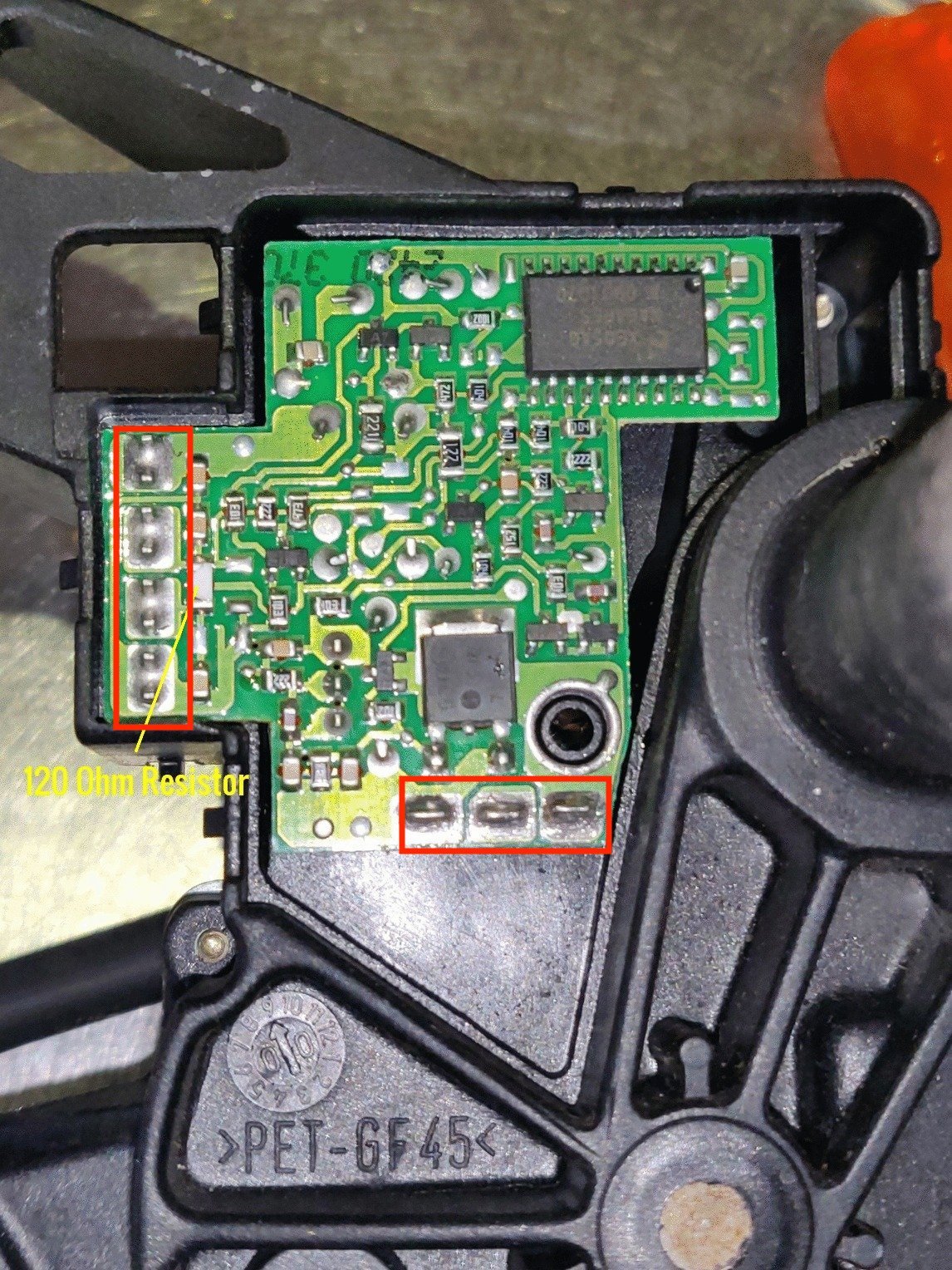

After I removed the motor for diagnostic it seems that there was a problem with the grounding on the electronic board from the wiper.
I’ve just resoldered it and everything works fine.

Hello,
Unfortunately I didn't take any picture.
Based on the pictures that I found on the internet here is the electronic board and here is the ground that I had problems with. I've just resoldered the ground and everything worked perfect.

Oh, ok.
I was thinking on the ground in the wiring loom - the point where it grounds to the chassis.
I didn't even considered the possibility of solder failures on the pcb - thanks for the heads up.
