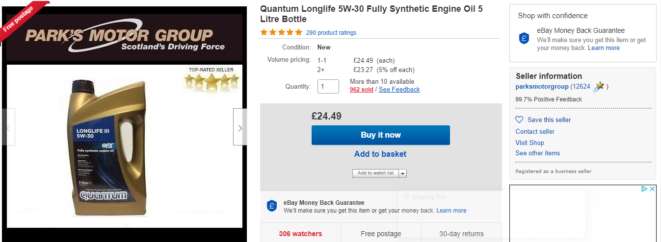

Quantum 5w 30 FS III (long Life) is what many VW / Skoda Dealerships use.   VW504 /507.
