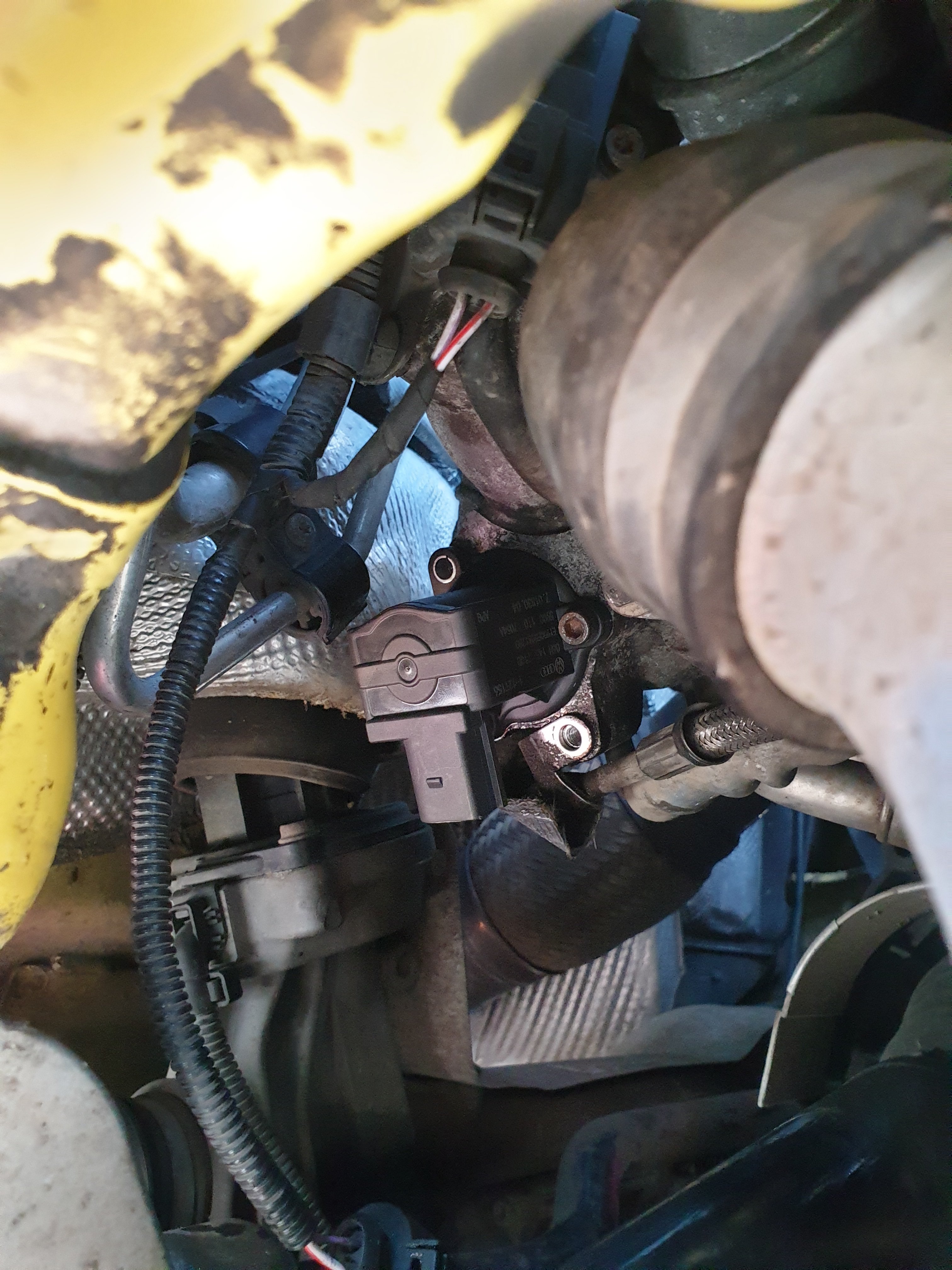

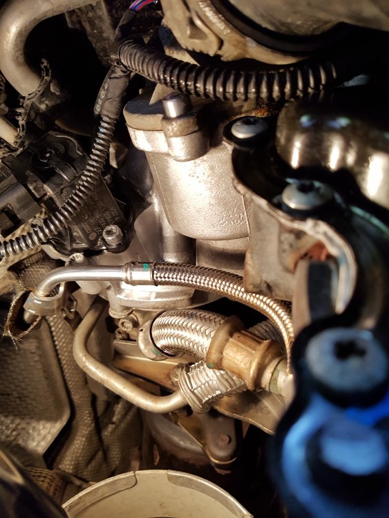

Could this be the issue at last !!
Just looking through pics of my dv change, noticed theres a bolt or valve missing lower right of dv !! Could this be my boost leak or is it just a missing bolt only ??
And yes i did fit the other bolts holding dv in place 😂
The diverter is supposed to have 3 bolts, I can only see the one. Are all 3 in place and firm.?
The bolt missing is for a support for the oil or coolant line.  It wouldn't affect boost.

Have no access to mapping or logging, all 3 bolts are in place, photo was taken during instal. As for boost i can hear it building, it picks up sweet till approx 3k then nothing. Just unplugged maf and it drives alot better. Still not enough power to spin the wheels in 1st but def up on what it was, i am assuming as now my eml lights come on it could be limp mode / reduced power due to unplugged maf ?
