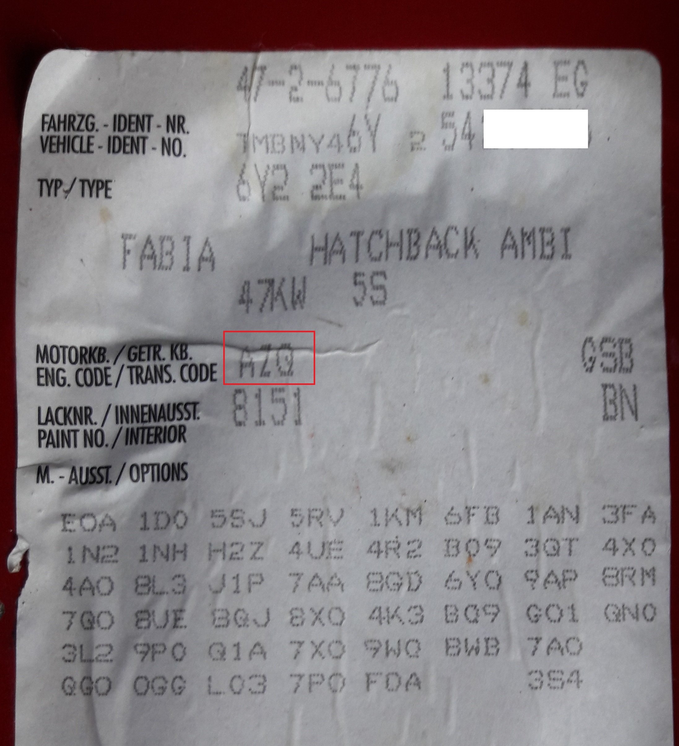

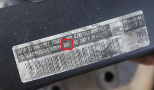

On the data sticker on the boot floor, or on the barcode sticker on the upper cambelt cover.
Here are some examples: boot sticker and cambelt cover sticker (different engines, different codes):

BSE it says does that help
  • Sponsor
Yep, that confirms what I guessed at in my first reply, so should be 06A906262BR.
