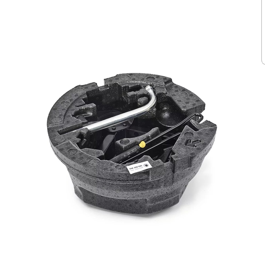

My spare has arrived today, from a Golf MK5 I think. Does anyone know if there is a replacement nut/bolt that raises up to the level of the boot floor? The one that came with the wheel leaves about a 10cm cap under the floor, so the floor collapses.
There's a polystyrene insert to hold the jack and wheel brace etc, which supports the floor, like this:
Cheers, that makes sense, I'll try and find a part number for it.
The part number sticker on the one in the photo reads 5E0093860
Perfect, thank you.
Superskoda.com sell them.
