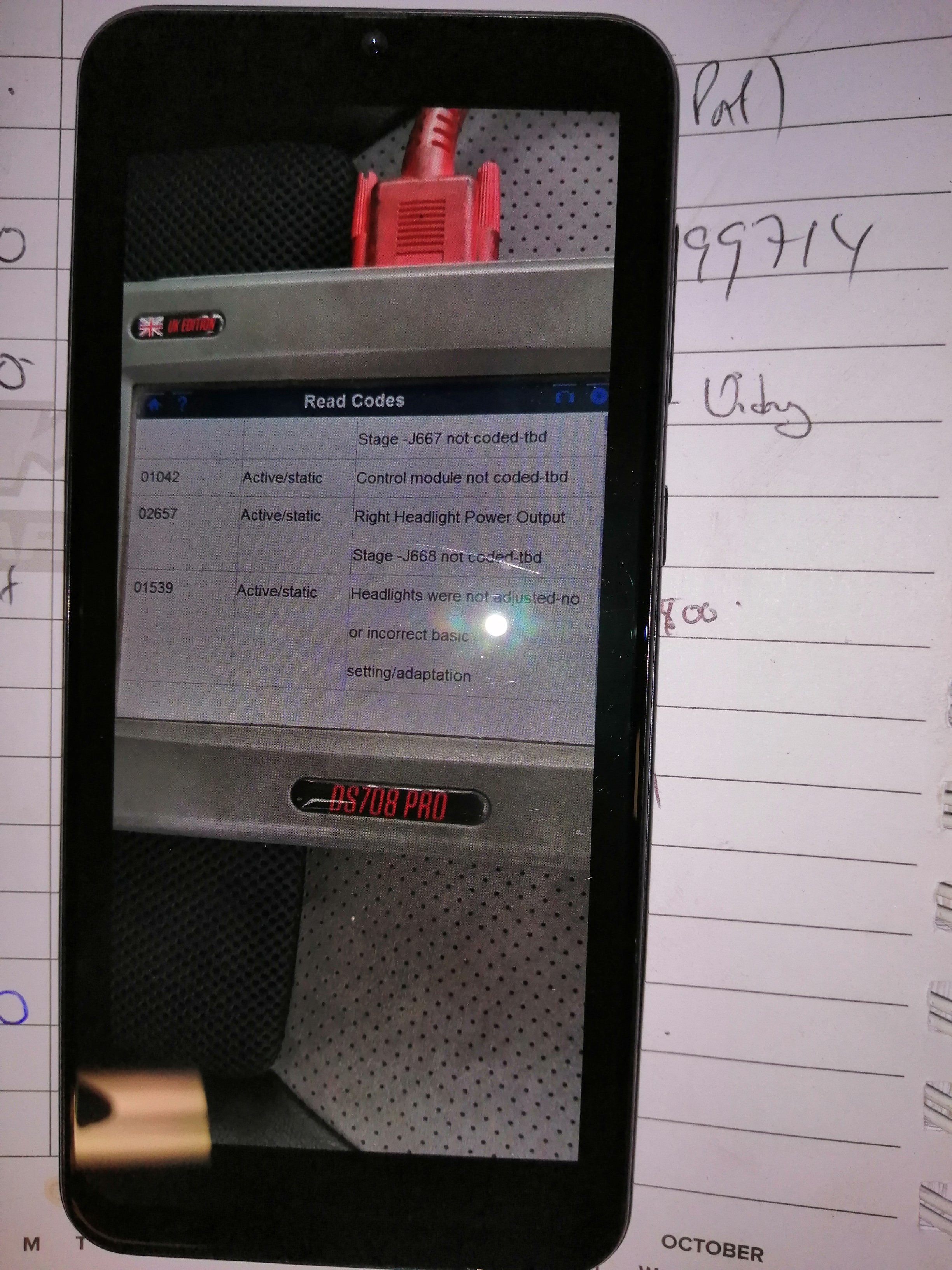

here are the codes the auto electrician are showing me (01042, 02657, 01539)  i made another phone call today to the skoda main dealer and the have told me its a waste of time bringing it back to them as there is nothing they can do as there programmes wont be able to do anything for this........
Based on those codes, you have xenon headlights. Assuming you do, looks like they need coding (was a headlight replaced?) and then the basic settings completing.
