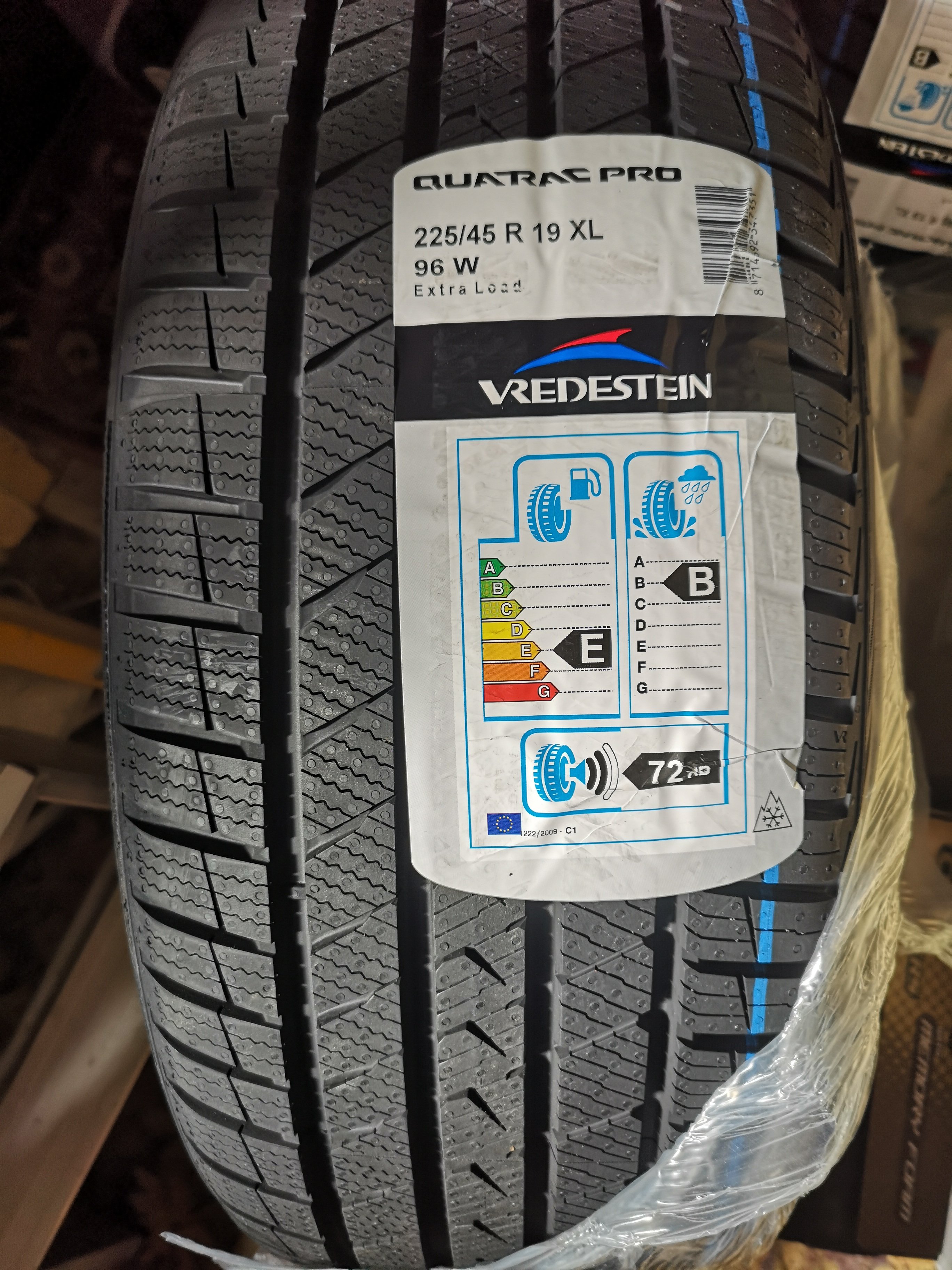

Due to the tracking screwing up my front tyres and not having been over impressed with the Bridgestones I have just ordered 4 Vredestein quatrac Pro 225/45 r19 all seasons for my 2.0l tdi 4x4 dsg as the choice for a decent all season tyre seems quite limited.

Get a 4 wheel alignment done straight after new tyres fitted.
If you can try and find a Hunter alignment centre, then should be sorted properly.
Some tyre centres will offer realignment but not as comprehensive as will probably just reset basic tracking.
Good choice of tyre, suggest you swap front-back in about another 14k miles to even out the wear.

Tyres arrived, just waiting for the tracking to be sorted so I can get them fitted.
I have the new tyres on and then the tracking and alignment checked and adjusted if needed before driving with them.
