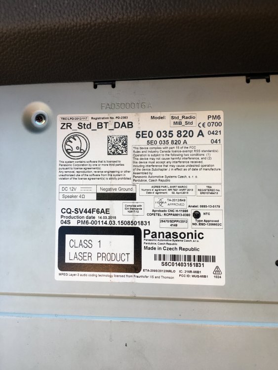

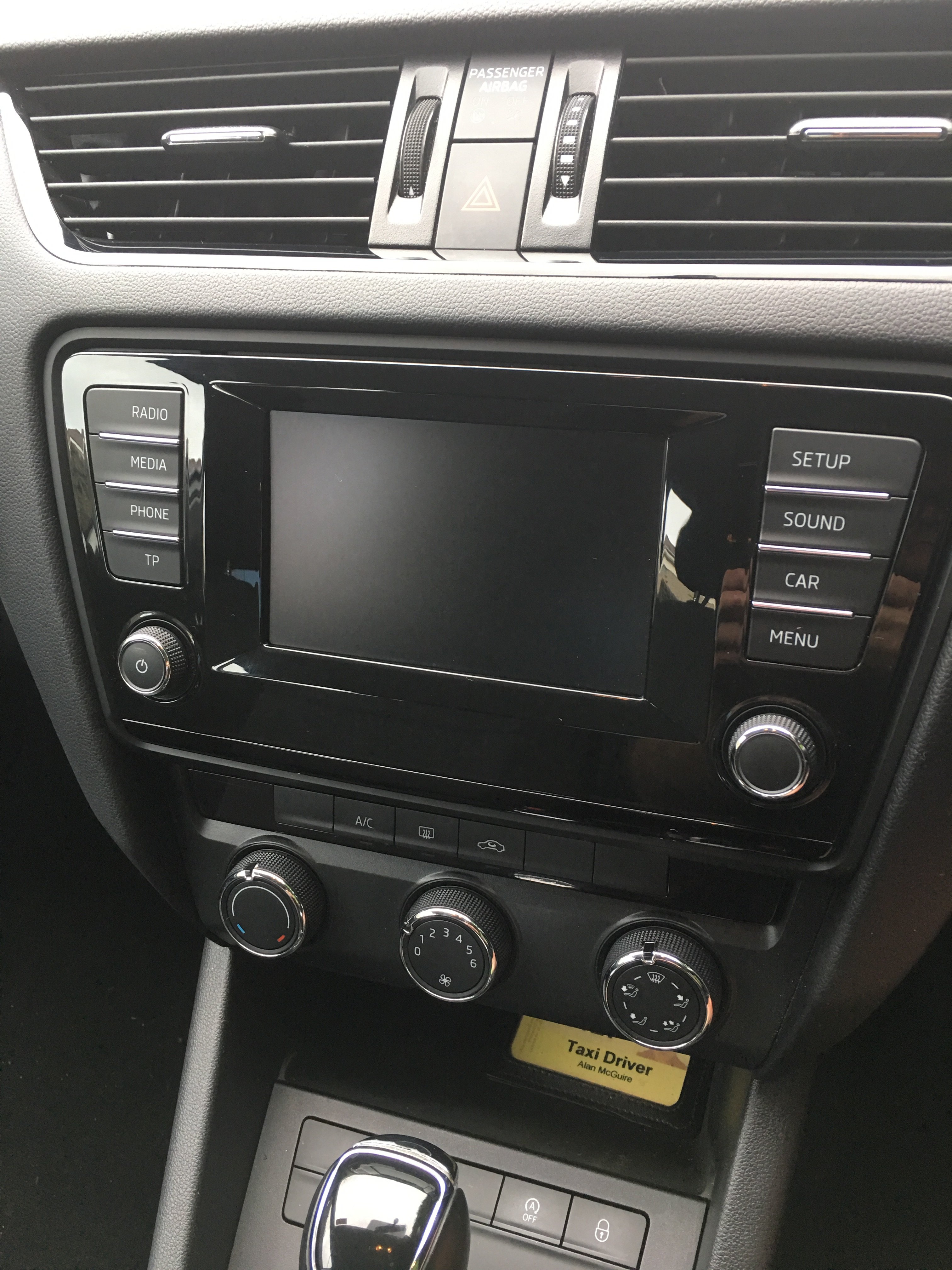

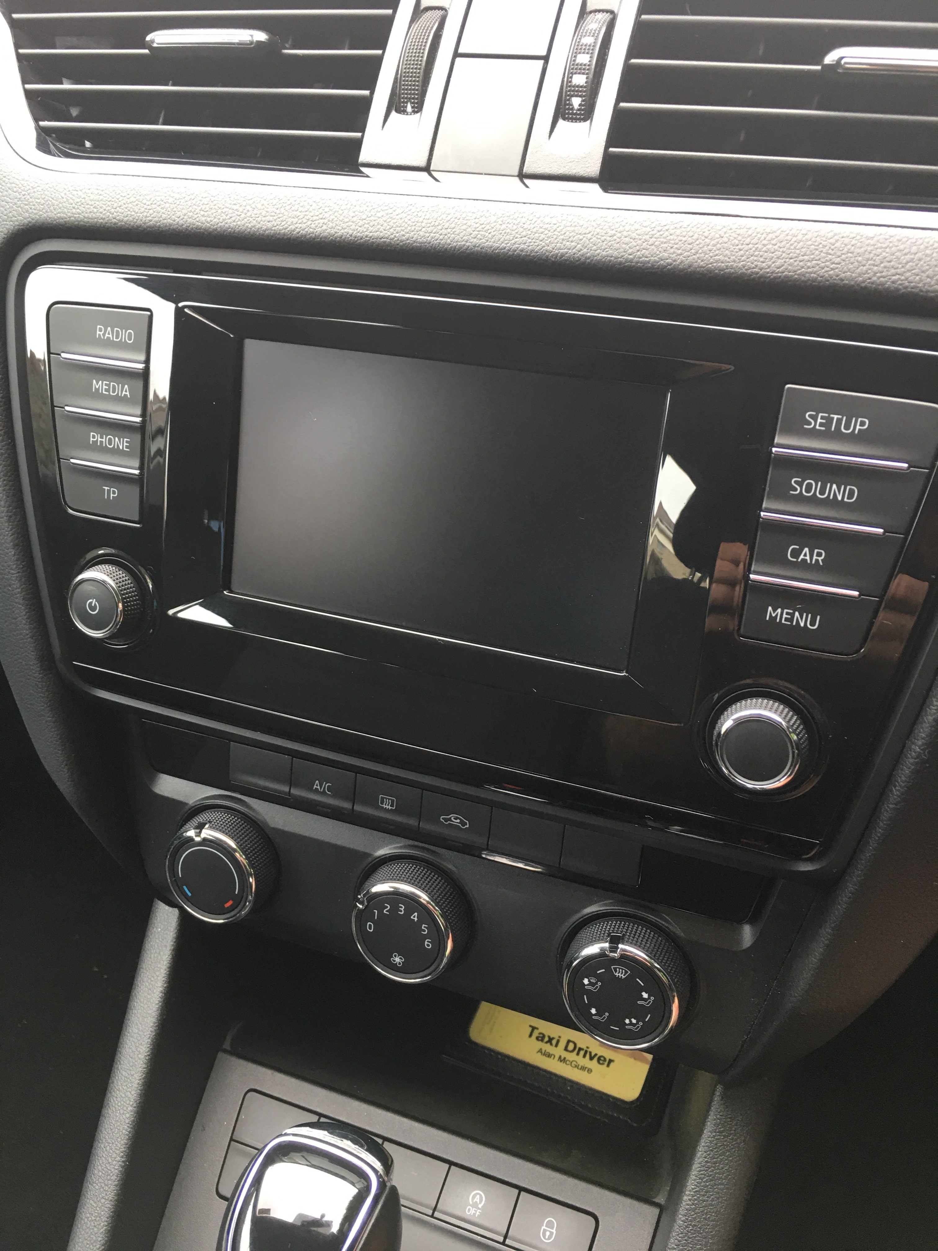

Depends what radio you have now. You need to check the part number ideally but if you can’t remove it to find out please post a pic of the screen and I may be able to tell you which control unit you need from that.
Thats the one in my car, i should be able to remove the unit if i can i will take a picture and post it

Received my bolero unit and it works fine but it looks like i need the dealership to code it in and its £108 to do that. I tried a company online with codes but the couldnt find the correct code for mine so my £18.99 was refunded. Any suggestions regarding obtaining the code??
As mentioned in the other thread you will need to go to the dealer and pay for CP removal. These radios aren’t coded with a 4-6 digit code like radios in older cars. They are coded to the car’s chassis number and are locked down on a software level by VAG to prevent theft (and give a nice earner for them to remove CP on new and used parts). This process can only be done with ODIS-E with online access to VAG in Germany.
