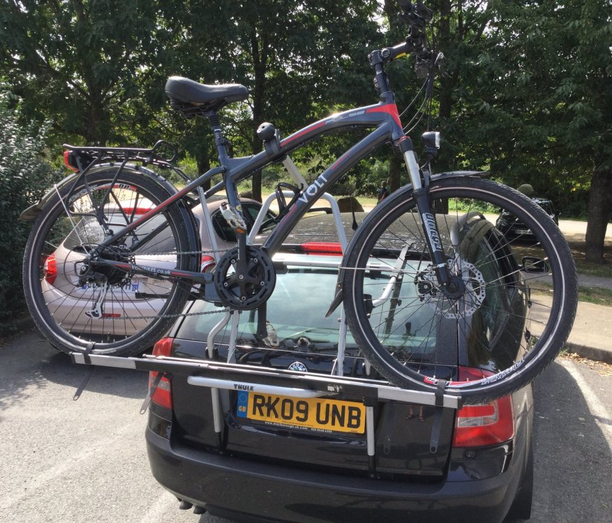

I have a Thule bike rack (Clip on high 9106/9105) for 10 years.
This is attached to the rear hatch of my estate Octavia and can see that clears the number plate and brake lights.
I have no problems when I using it to travel across europe and loading on to ferries.
I have used it carry normal bike 15kg or my  ebike 21kg.
When I use it I lose about 10mpg because of the drag.
