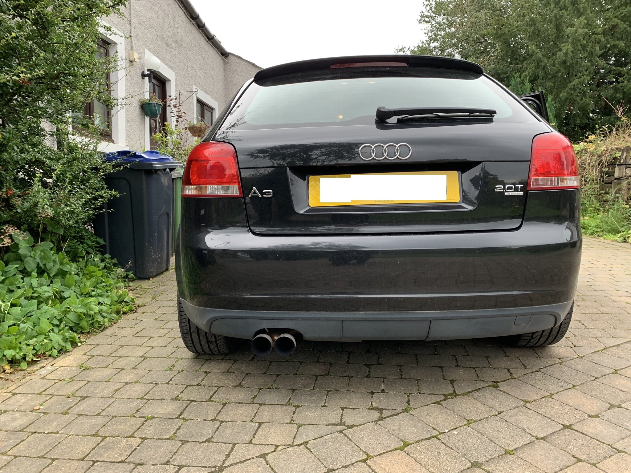

Hey all, not new to brisky, but not been in here before... we have just bought an audi A3 (2006) 2.0 tfsi quattro.... I believe its the same engine as the mk2 octy vRS .... I have a few questions.... how many of you have changed (or had a problem with ) the cam follower that runs the fuel pump ?  any issues with the chain that runs the cams? just trying to look for stuff to "pre-empt" to maintain it properly... Thanks!
