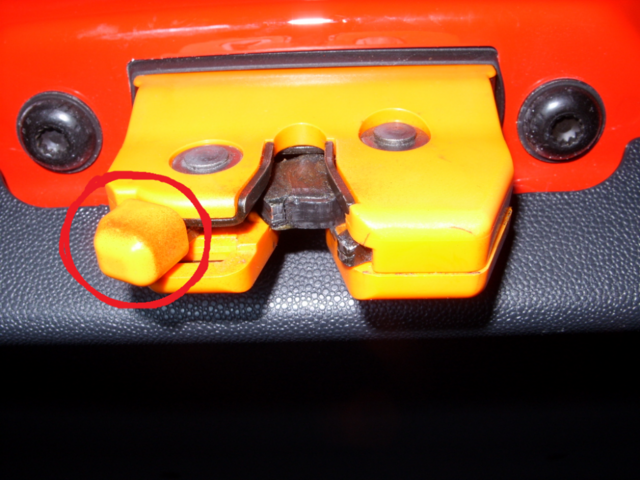

There is a spring-loaded plunger that pops the lid open past the catch. Give it a push to check if it still has a firm spring action...

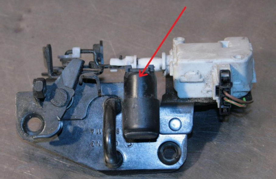

Thanks for the reply & pic,
The spring plunger id fine. Ive had another look and the issue seems to be the parts on the left side.
I think the part that pushes the orange release lever in the bootlid has possibly come away from something as it seems to be flapping around, or not has enough strength to operate the lever?
Does that make sense?
Cheer,
Rob
Yeah the white bit is the solenoid/motor that pushes the lever. It might be faulty or some other part of the lever mechanism might be stiff or not working correctly.
