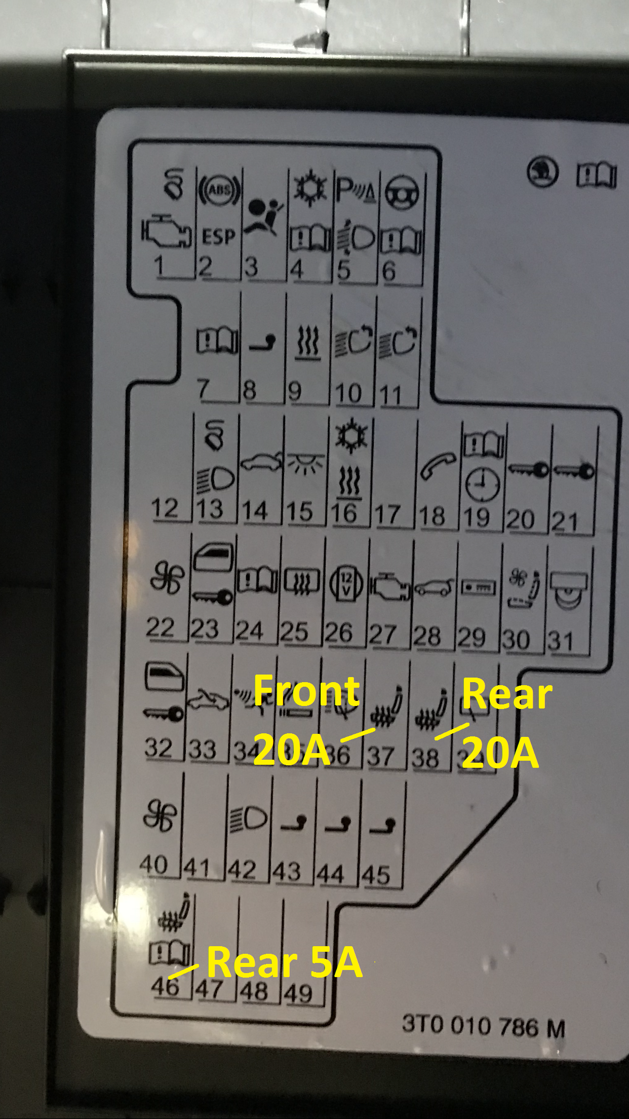

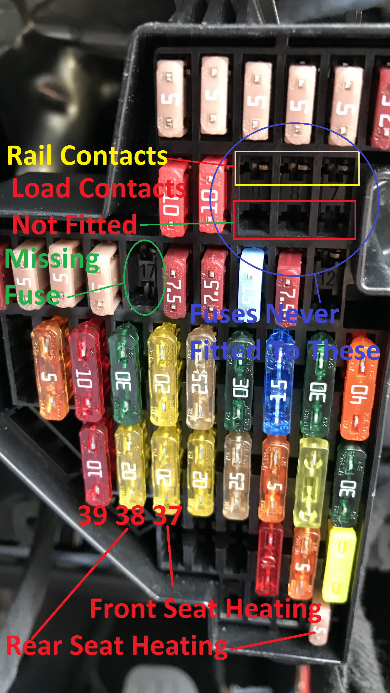

The legend (shown on the right) for the fuses is for LHD cars,
The RHD fuse box is shown on the left I have marked the positions at the bottom for the seat fuse positions, disregard the top markings as they were for something else.
Blown fuse would indicate a shorted mat or wire, VW passats had an issue where the mat shorted on the metal seat frame and were subject to a campaign, that was a few years back though.
Thanks, 3T51704x4, that is a great answer, really informative and helpful and I appreciate the images. I’ll check it out as soon as I get the chance. Thanks for taking the time, I’ll post an update when I’ve now done a bit more on the investigative front!
Hah, this is great - no blown fuse (unfortunately), although the 20A next to it was blown, so I swopped them over. All of a sudden I have functional headlamp washers that I never knew I had!! (had car for three years...., doh). A ‘win’ on that front, but no further forward with the seats. Is the heater control unit you mention, accessible, and/or is there anything else I can check? Thanks again, Andrew.
