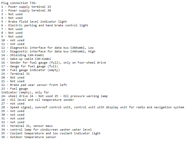

I bought instrument cluster from Skoda Octavia A5 car (2008 year) for my project. And now, i want to make it works on table.
Recently I have dashboard from Renalult Trafic, and made it works (all functions, tacho, speedo, indicators e.t.) with CAN bus.

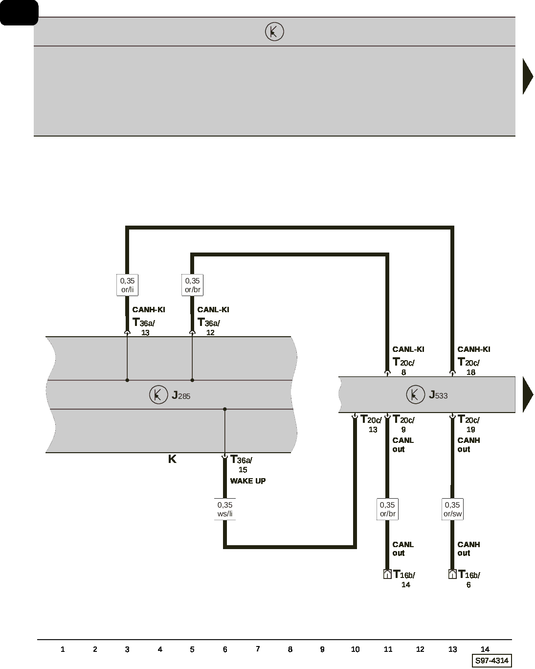

But i can`t connect Skoda dash to the arduino (with CAN bus module) - it doesn`t send any data to CAN bus, and no reaction to any CAN messages 😞
Maybe problem in "wake up" wire (15 pin on dashboard connector) ? What should he do? In the diagram, it is connected to the gateway block.
Connection is right, works with Renault well.
Any ideas ?
