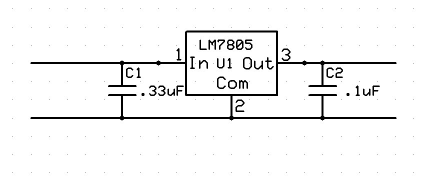

As said- my first port of call would be the 12-5 convertor. Easy way to find out. Get hold of one of the plug in 12v- USB convertors. Chances are that it will be based on a 7805 IC( most I've opened were), which does not rely on  chopping the DC to convert to a near AC square wave. Noise gone, chances are that it's the cheap (and nasty ) dashcam voltage convertor.
Problem is that a square wave consists of many harmonics ( multiples of the original frequency ). Adding ferrites to the exterior can cure this sort of problem, but in the worst case you need a PI filter consisting of a series RF inductor ( cheaper models use a resistor )with capacitors across the supply.

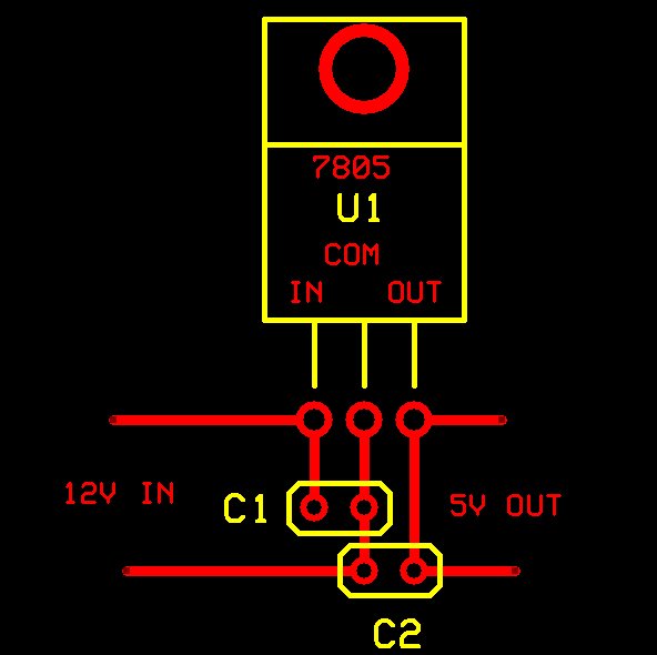

It might seem complicated, but even a home brew 7805 convertor is easy to make . It needs a 7805 IC ( 1A or 1.5A version) , which has three terminals- in out and common. Add to this a couple of smoothing capacitors. In cap =.33uF connected across the in and common, OUT CAP =.1uF connected across the out and common. If the IC gets warm to the touch, add a heatsink.
