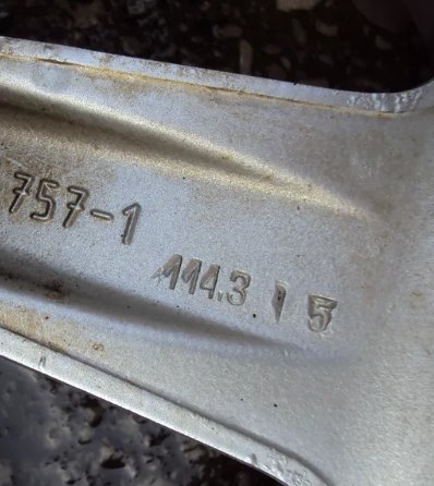

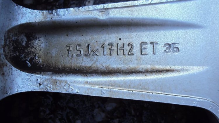

 Can you please help? I would like to go for different wheels and I found something what I would like but they are smaller and all other parameters are different to original alloys.
I’m also after your opinion: what do you think about going down from 18 to 17 (when it comes to alloys of course 😂 )
Please see below pictures:

It looks completely the wrong specification of rim.
The BCD shows 5/114.3 and should be 5/112 for the Skoda Octavia MK2.
I doubt the centre bore is 57.1mm
The ET35 offset is not enough for 225/45R17 tyres on the Skoda Octavia MK2.
