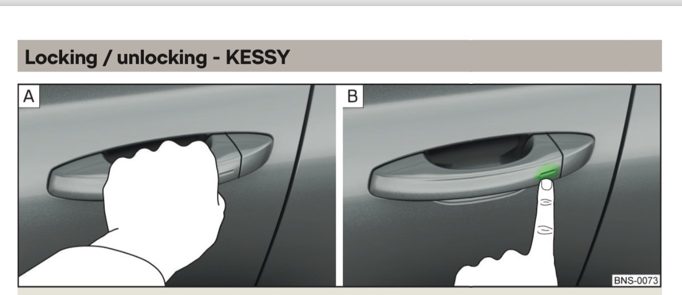

When locking, you must only touch the small indent shown (B) and no other part of the handle.
Thank you for this,
as you show when just touching the button and not the handle , it locks!

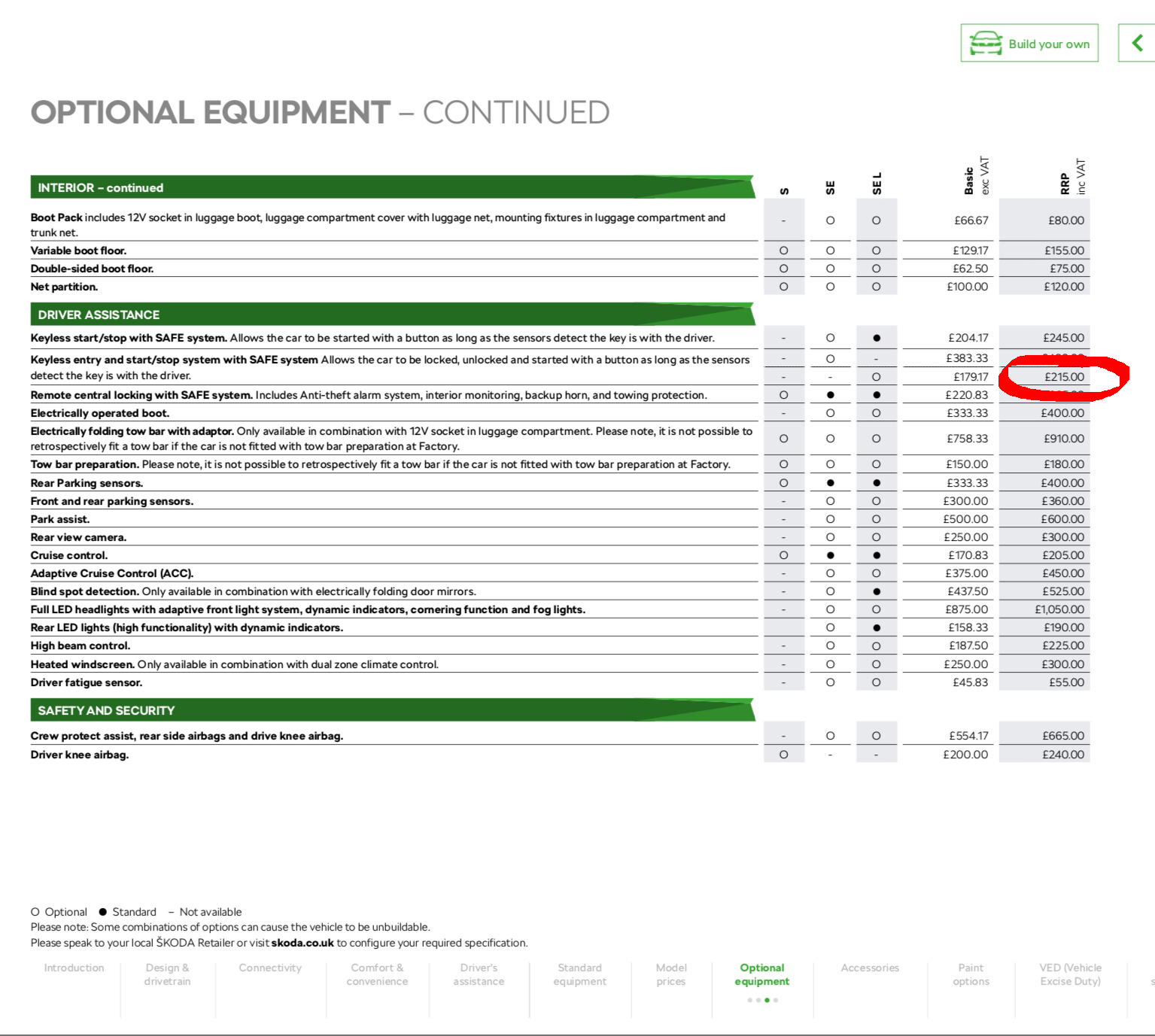

I raised a query with my dealers about keyless locking/unlocking not working for me and got the reply:-
"The kamiq does not have the full Kessy system, it only has the keyless stop/start.
This mean you can only open the car with the key fob."
Can anyone with a Kamiq confirm that theirs does in fact work and what spec it is.
According to the pricing and specification document keyless entry is a £215 option on the SEL.
Edited by Kenny R
Thanks, that explains that then. Mine was already built and being shipped when I ordered it so no optional extras.
My bad to some extent for not realising that there are different degrees of keylessness 😄

As per the picture in second post, to Unlock, your fingers have to be touching the inside surface of the door handle. Only the inside.
To lock the car, your fingers have to touch the outside of the handle. Only the outside.
You don’t have to precisely touch the spot with one finger. I touch the handle with either my palm, my finger tips or the back of my hand. It all works easily.
Can even be locked or unlocked by someone who is NOT carrying the key if the key carrier is standing close enough to the car.
Enjoy.
