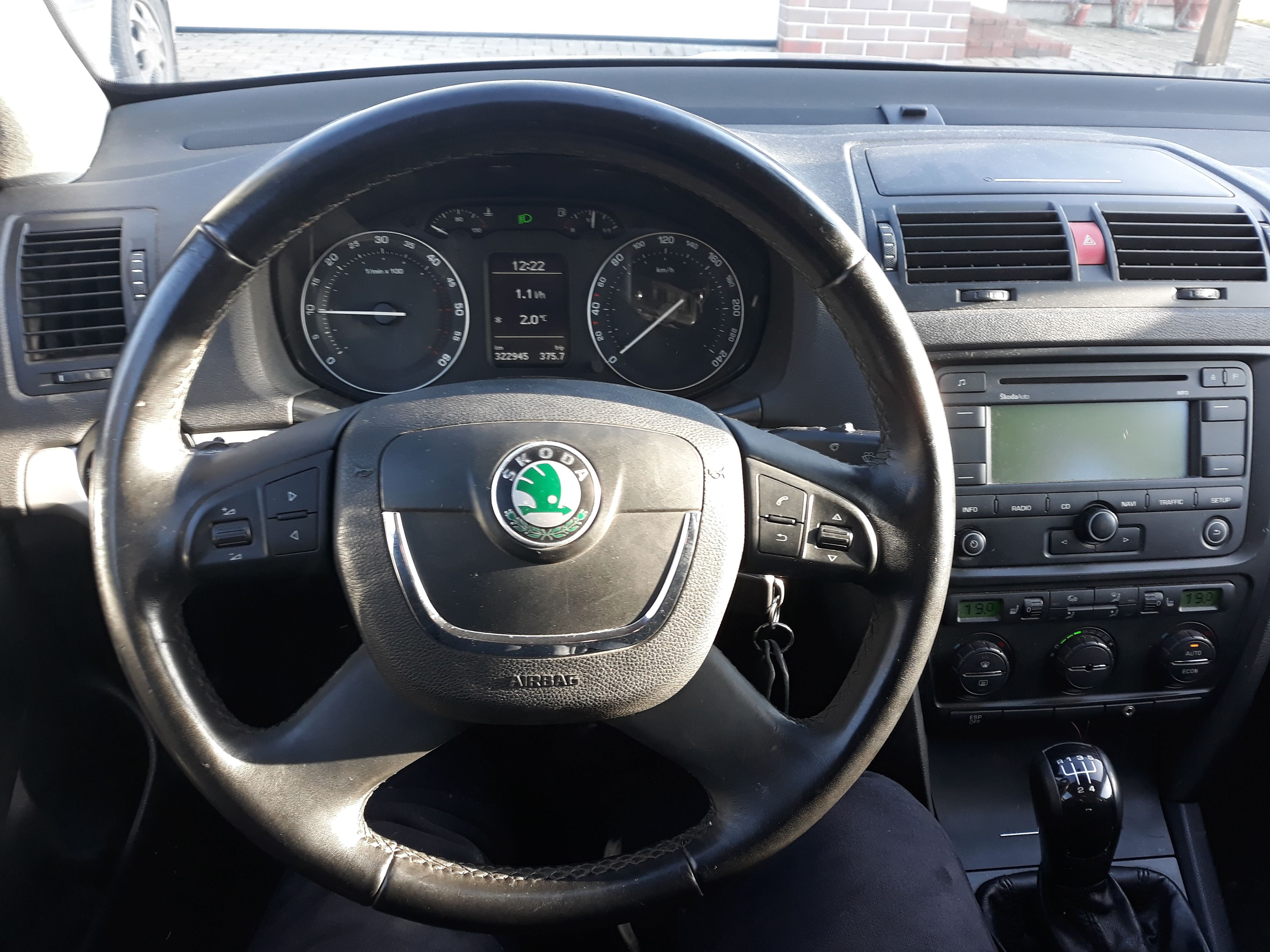

My situationis that I have 2006 Octavia II, which is pre-FL. I decided to retrofit a MFSW and looked for best solution. I found only one variant for a normal price - a mint condition MFSW from a Superb 3T with a wiring loom..
So now i have this wheel fitted with module 1K0953549CH. The current view is in the attachment. Steering angle sensor calibrated, horn works and that would be mostly OK...
But I have some issues - steering wheel buttons don't work properly. Left side works strange - just when I press station change arrow the radio tunes to the same station but doesn't change to other. Right side - works only OK button when I press the roller.
