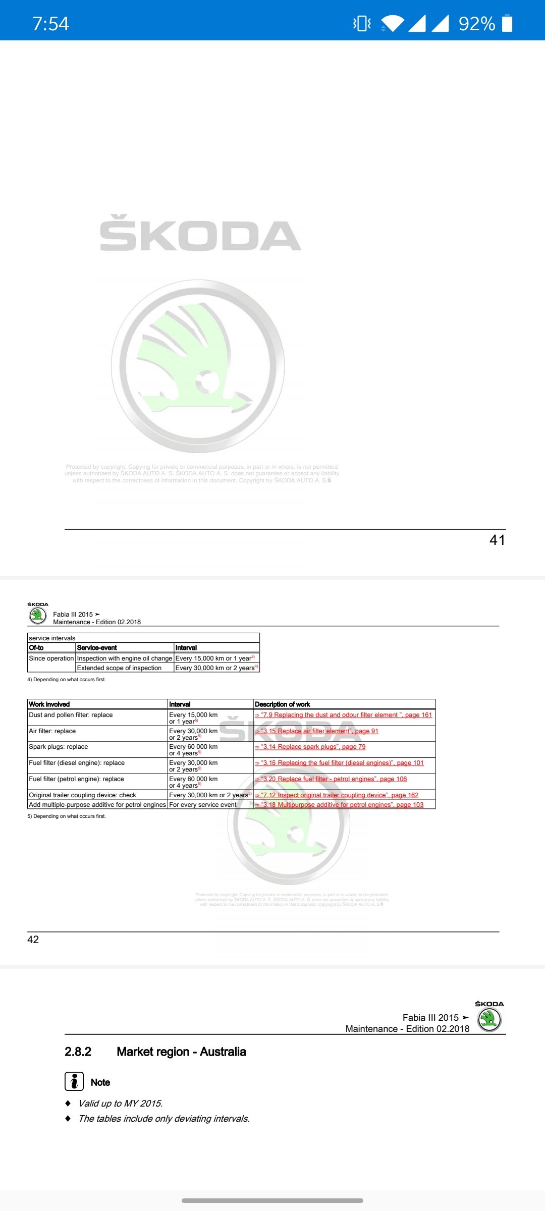

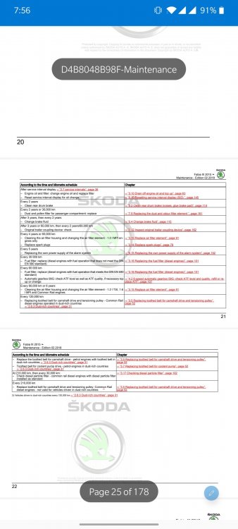

I service mine as below.
10k oil and filter.
20k, oil, oil filter, fuel filter and air filter. Pollen I'll just check and change if need be.
Only use VW/ Skoda parts as I got a duff fuel filter from MANN that leaked and then noticed around one of the outlets it was missing and extra layer of reinforcement that was on the original.
I have all the part numbers if you want for the above items.
Oil is use Quantum,

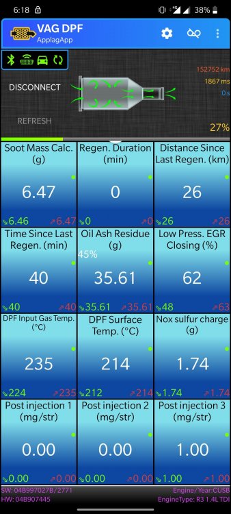

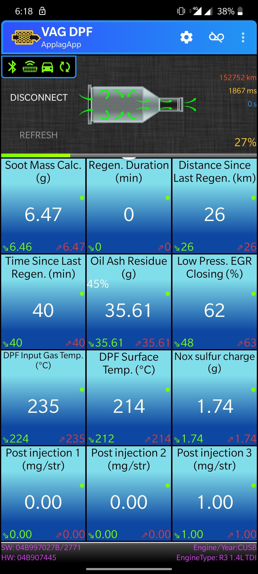

I also took a screen shot of VAG Dpf of my car last night attached.
Thanks @owilliams1 ! That’s a great reply and very helpful! Are your numbers in miles or kilometers?
Are you using the android VAG dpf app? There isn’t an alternative for iPhone is there?

Those numbers are KM, im on around 95k miles now.
Yes im using that app, not sure if there is an iphone version, i got paranoid in my last car a Superb about the DPF so i bough a Bluetooth and the app to check it was working ok.
