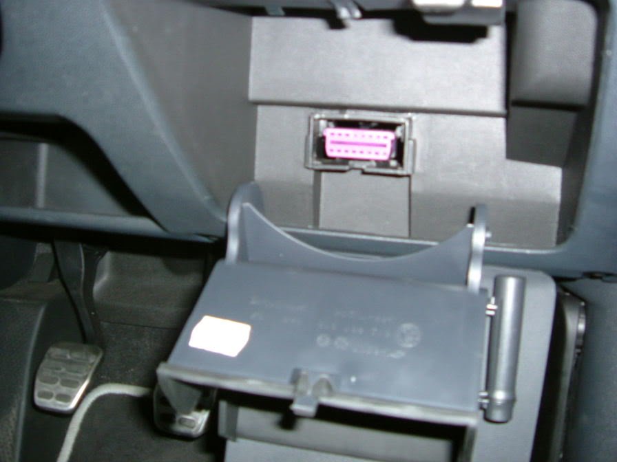

A slightly rough idle is a trait of the 1.4 MPI. It shouldn't do it when driving it though. Needs scanning for fault codes. You can buy cheap scanners on ebay - the U281 for example. The diagnostic port is behind the cubby on the drivers side. Pull the lid right down past its normal stop to access it.
