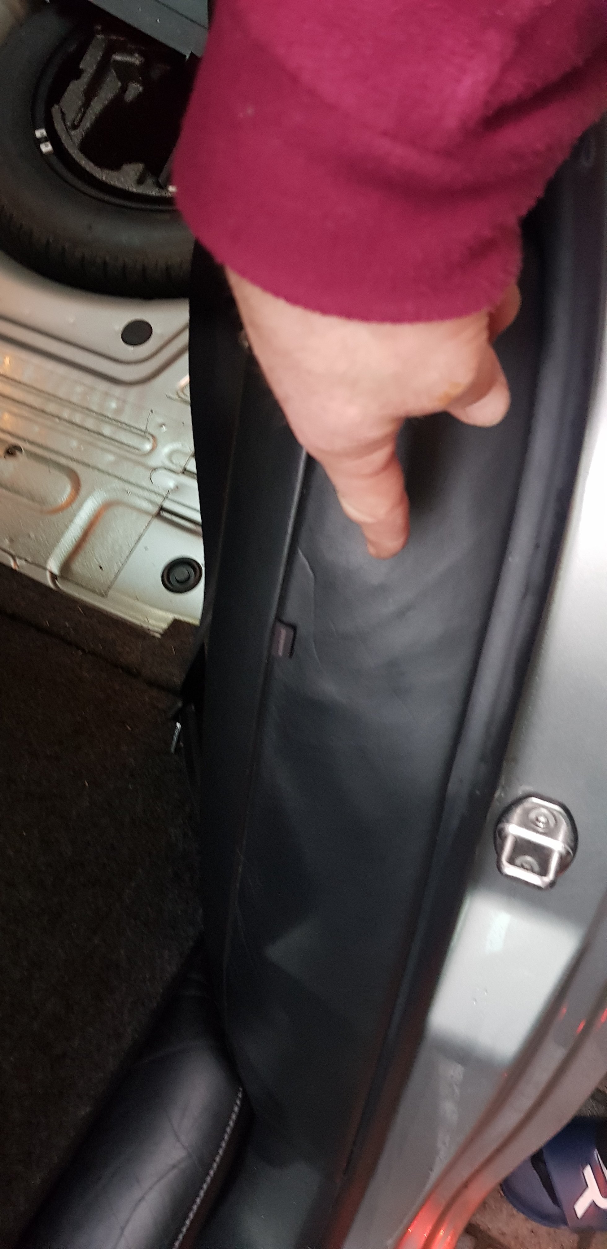

Can someone please tell me how to remove these?  Thanks
I thought they can be moved upwards by a few cm, and than you can remove them (towards the inside of the car).
If they contain airbags: don't forget to disconnect the battery first!
It is a pain to remove. I put it into a write up for a RVC retrofit.
