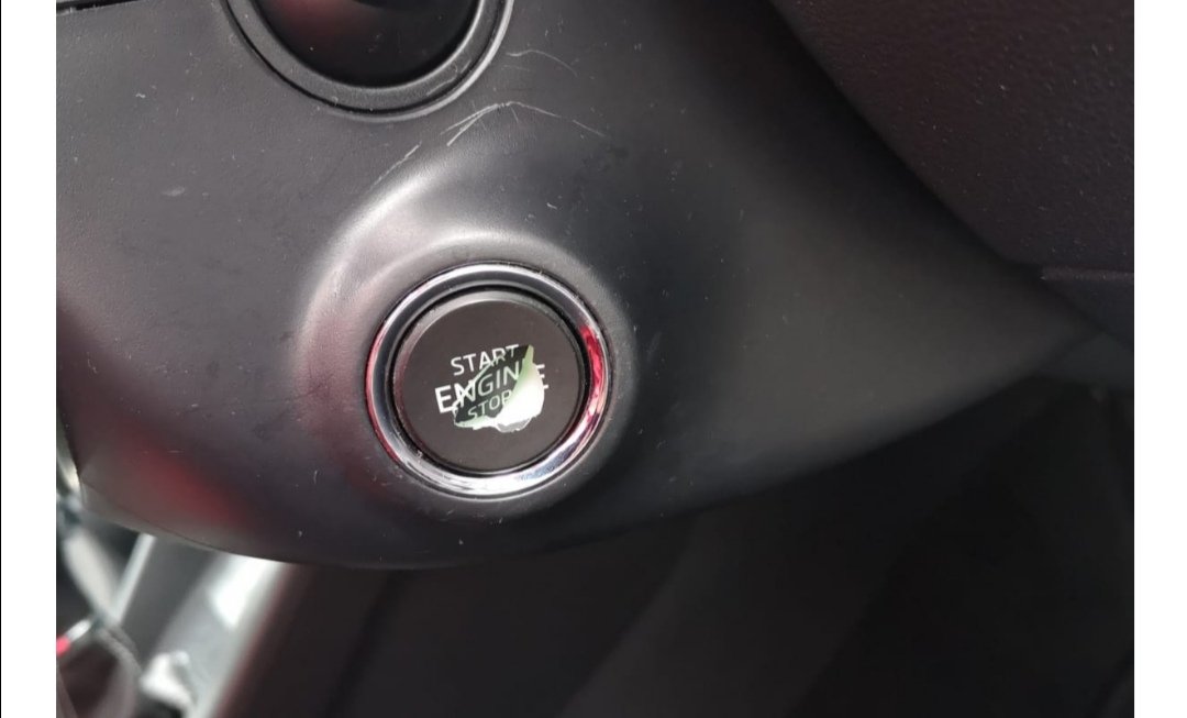

Thanks for quick reply. The wife damaged if when pushing key against it when key battery died!! Tried warranty route but told not covered. I have attached picture to show damage us this same part you are referring too?. Will have a look under part number online.
Ahhh, the KESSY start button. Sorry, I thought you meant the Auto Start/Stop button. Either way, used but good condition KESSY start buttons are on eBay for about the £25 mark. Part number is 5E0905217WHS.

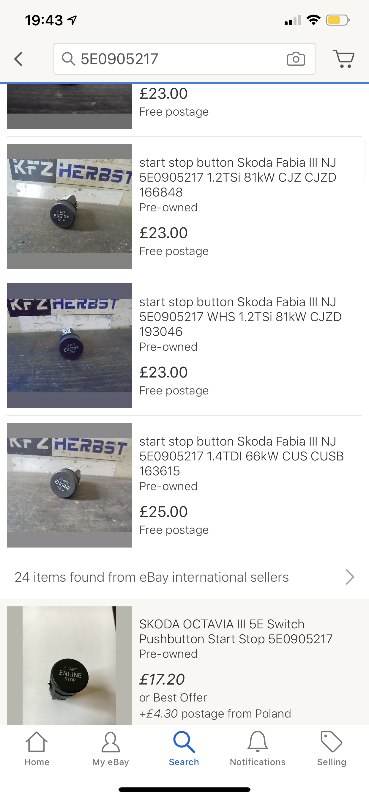

Sorry wasn't sure exact name for part. Maybe dealer is also thinking of different part as I explained it over phone. Do you know how I can find them on eBay via part number as only getting results showing keys?
Search the part number without the WHS and you’ll see this
Perfect thanks. Are these simple to fit
Yes, remove the steering cowling and the button is clipped in place and there is one plug to change over.
