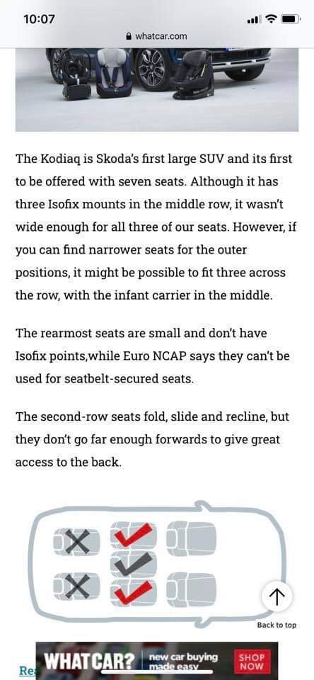

If I recall, NCAP advise against fitting child seats in the 3rd row of the Kodiaq.

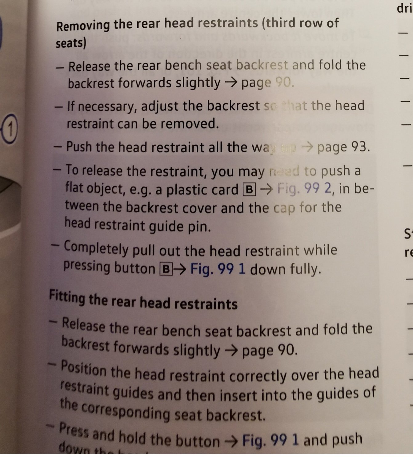

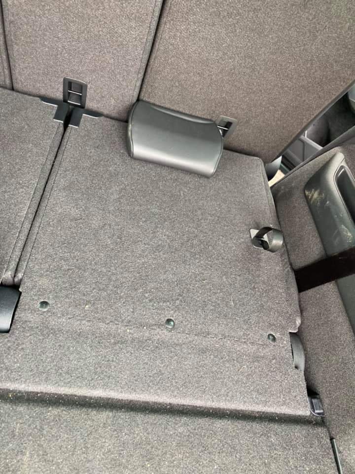

There is a hidden release for the headrests, you can then fully remove them, spin them around and reinsert them facing backwards. The third row seats even still fold flat with the headrests in this orientation.
This is the reason NCAP advise against their use, the headrests interfere with the correct fitment of a high-backed booster and Skoda do not communicate how to remove them so it has to be assumed they're fixed.
From another source.
The headrest release button...
The headrests rotated...

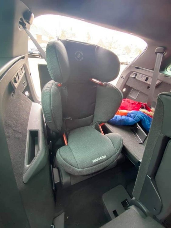

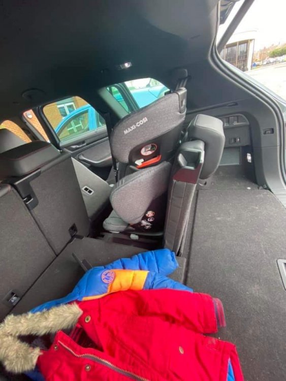

Another owners choice of seat...

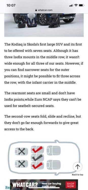

NCAP via Whatcar...
Found this guide in the Tiguan all space forum don’t know how relevant it is..but they’ve disabled the hidden catch so the headrests can be quickly released using the one catch on the post that’s visible same as most others.

Where does NCAP say it is the headrests that’s cause the issue(s)? In their official report they state only:
”no Universal restraints should be used in the optional third row seats.“

I didn't realise they said not to put car seats back there at all. With headrests removed I was happy with the high back booster similar to the post above pic, but would definitely have not put my toddlers seat there.

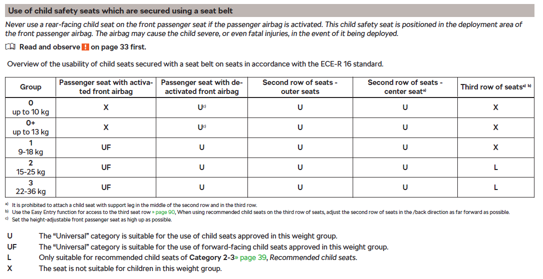

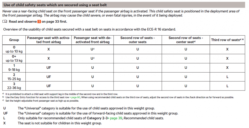

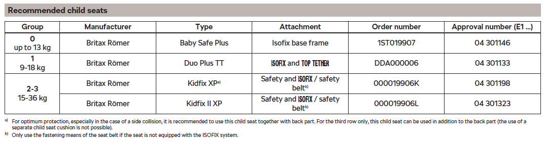

Skoda themselves promote the third row seats as being suitable for securing child seats...
The test procedure Skoda adhere to...
ECE-R 16
So it is wrong for you to claim that the reason that NCAP said “universal seats should not be used in the optional third row seats”. They’re quite explicit in their advice, and they’re experts who actually tested it. I know that a great many of your posts are genuinely helpful, and you mean well, but please recognise that handing out child seat fitment advice on the basis of what seems logical or plausible is not helpful, it’s just dangerous.
Skoda themselves explicitly state that the third row seats are not suitable for group 0 - 1 child seats. Whilst Skoda states that the third row meet the minimum legislative requirements for fitting booster seats, NCAP have a higher bar and suggest otherwise.

I have put a group 2-3 in the third row of mine but I wouldn't say it was perfect. I had to do this as my older kids cannot fit in the back of the kodiaq unless the middle row is push far forward.

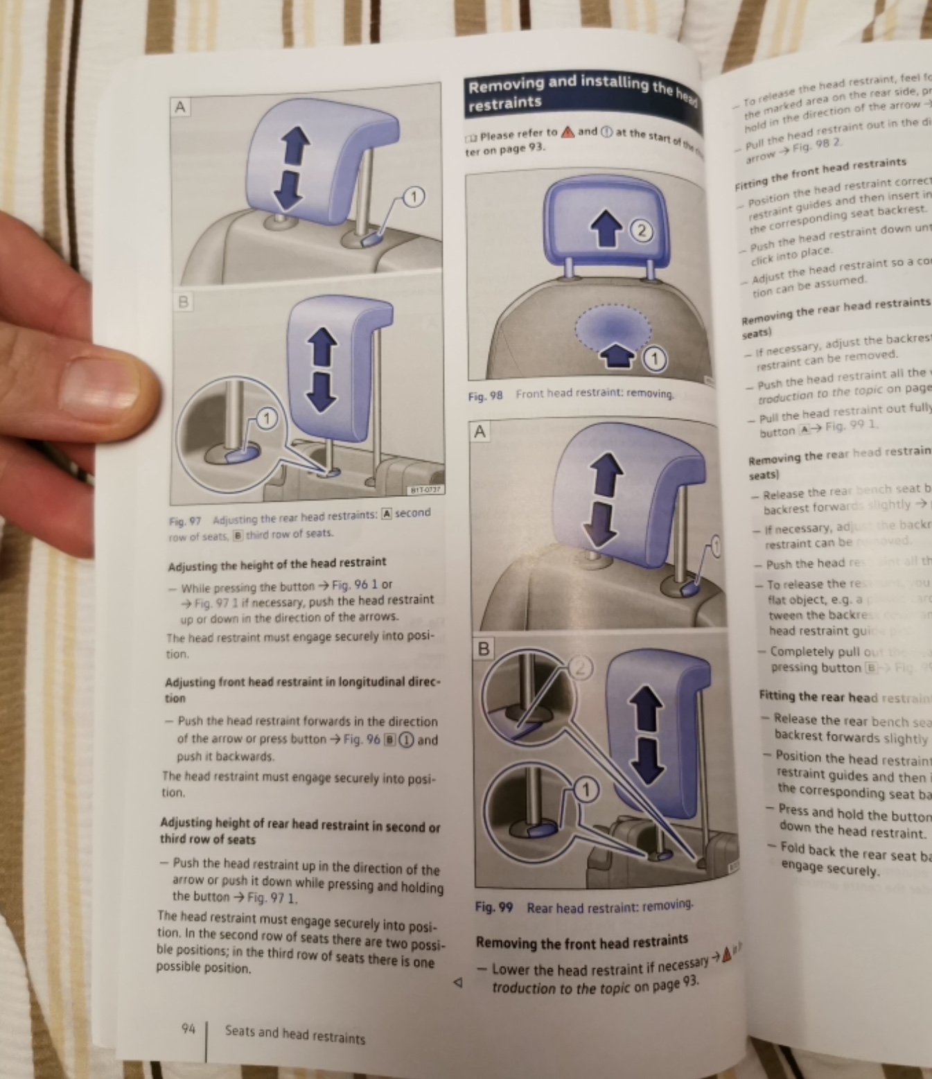

Why o why does the Kodiaq owners manual show you how to remove the 3rd row sear headrest.
Ive just followed this how to from the Tiguan forum and it o so simple when you know how. I also followed the guide posted above to disable the secondary lock, so I just need to push the locking clip on one side now to remove the headrests.
Is the word 'not' missing from your post?
I don't think Skoda want you to remove the headrests, they are integral to the safety of passengers, and probably for the limited child seats they approve for use in the third row the headrests don't need removing to allow them to fit.
Oops yes missed the not.
I’m not removing headrests just turning them round when I occasionally fit booster seats in the 3rd row.
Strange that VW show you how to operate the hidden catch with a credit card and Skoda don’t.
