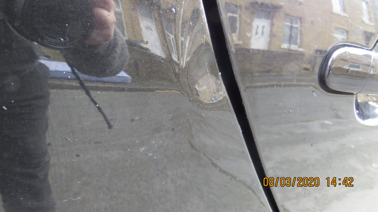

how to get dents off part of body?
hi guys
i have been looking on the net to remove dents but so far could only find solutions for only bumper and flat surface.
mine is on this part:
i stupidly used a claw hammer to try force the door open when it was deadlocked (to my defence i didn't know it was deadlocked)
cheers guys
Paintless dent removal... if the paint isn't broken. Look online for someone in your area.

thank you, have started getting quotes now.

Good. I paid about £80 after a colleague sat on the front bonnet edge of my last Octavia and dished it in. PDR result  was amazing.

wow....that is very cheap! im hoping mine will be that price. all i got to worry about after is getting rid of the scratches.

i have thought about ding it myself but if i make 1 mistake on the paint work then it might cost me more if i cant correct it.
Its in a area which is tight for working room from behind,due to the fold in the panel. There are Dent Devils (never used them myself),who will come out to you -you can upload pics for a quote.....
