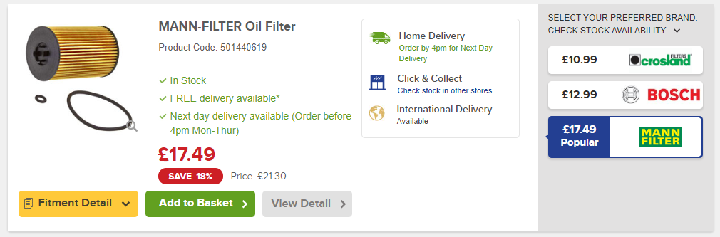

Genuine Skoda filters are made by MANN, I'd order the one above from Eurocarparts with their next day delivery.
