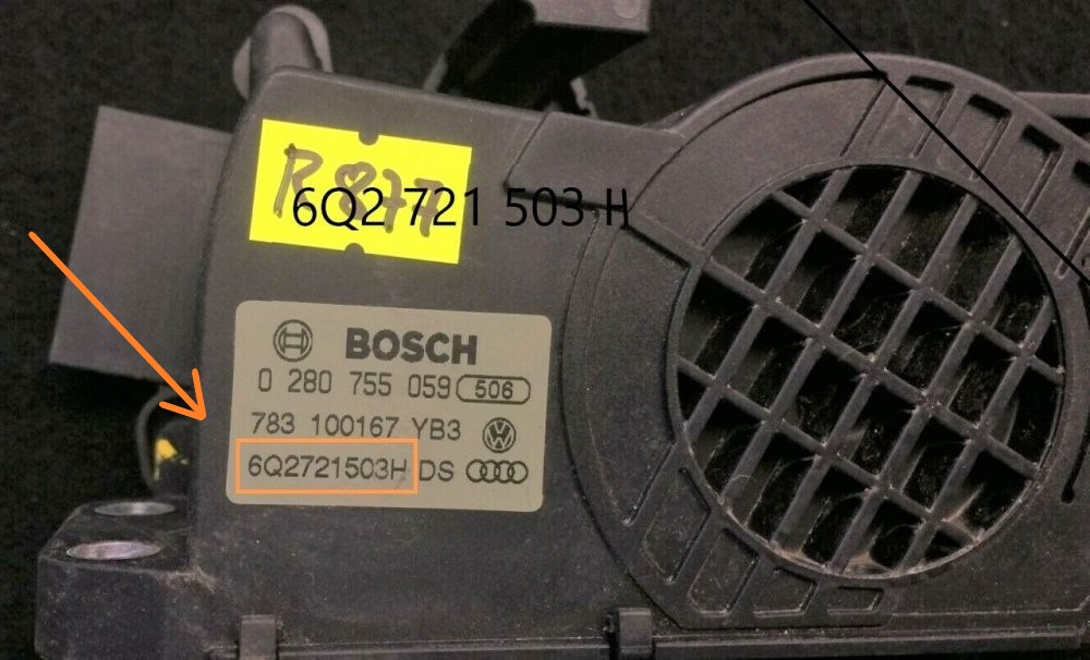

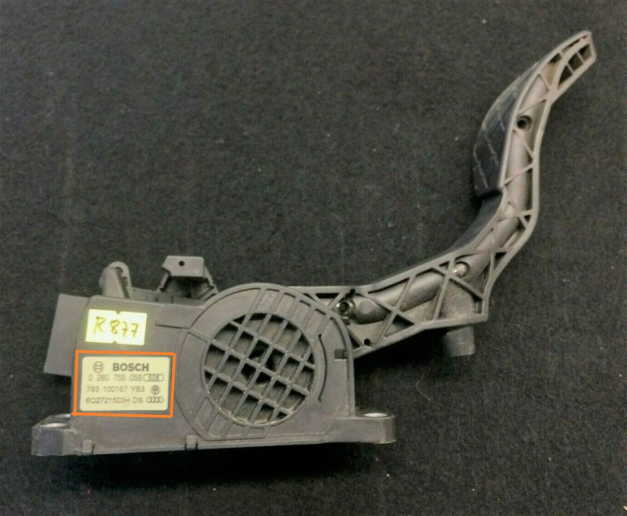

Choice of two depending on date.
Up to 29/05/2006 is part number 6Q2 721 503 F
From 01/06/06 is part number 6Q2 721 503 H
The number should be on a label on the pedal unit. Example...
