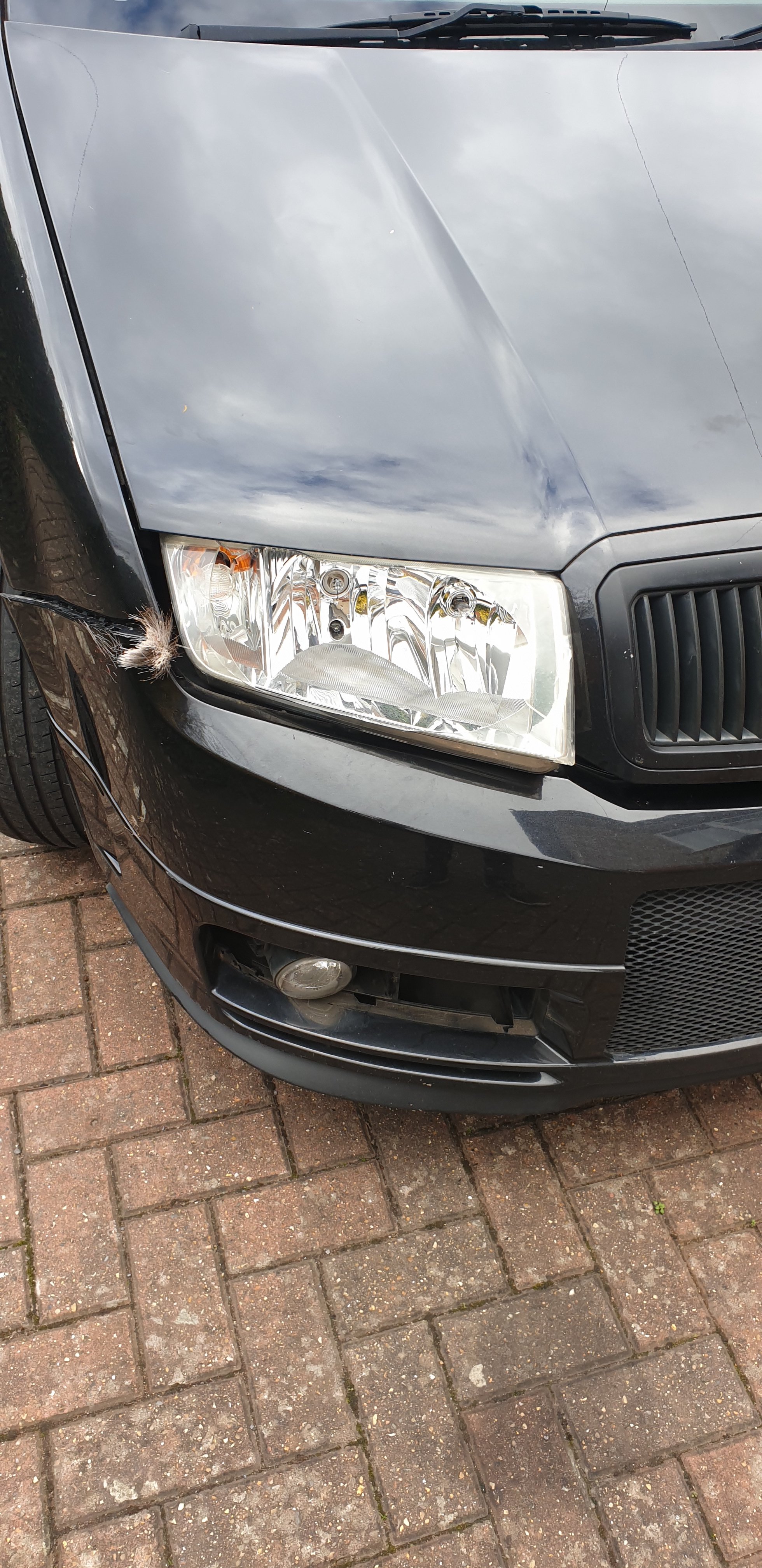

Hit a deer at the front driver's side, wooshing noise when coming on boost?
Unfortunately I hit a deer a few nights ago, hit the front left going around 50mph. Only visible damage was a smashed headlight and a cracked bumper. But theres an odd woosh when it comes on boost.
I've had the bumper off and checked for loose/cracked pipes and hoses but theres nothing I can see or hear.
Anything I need to check for?
