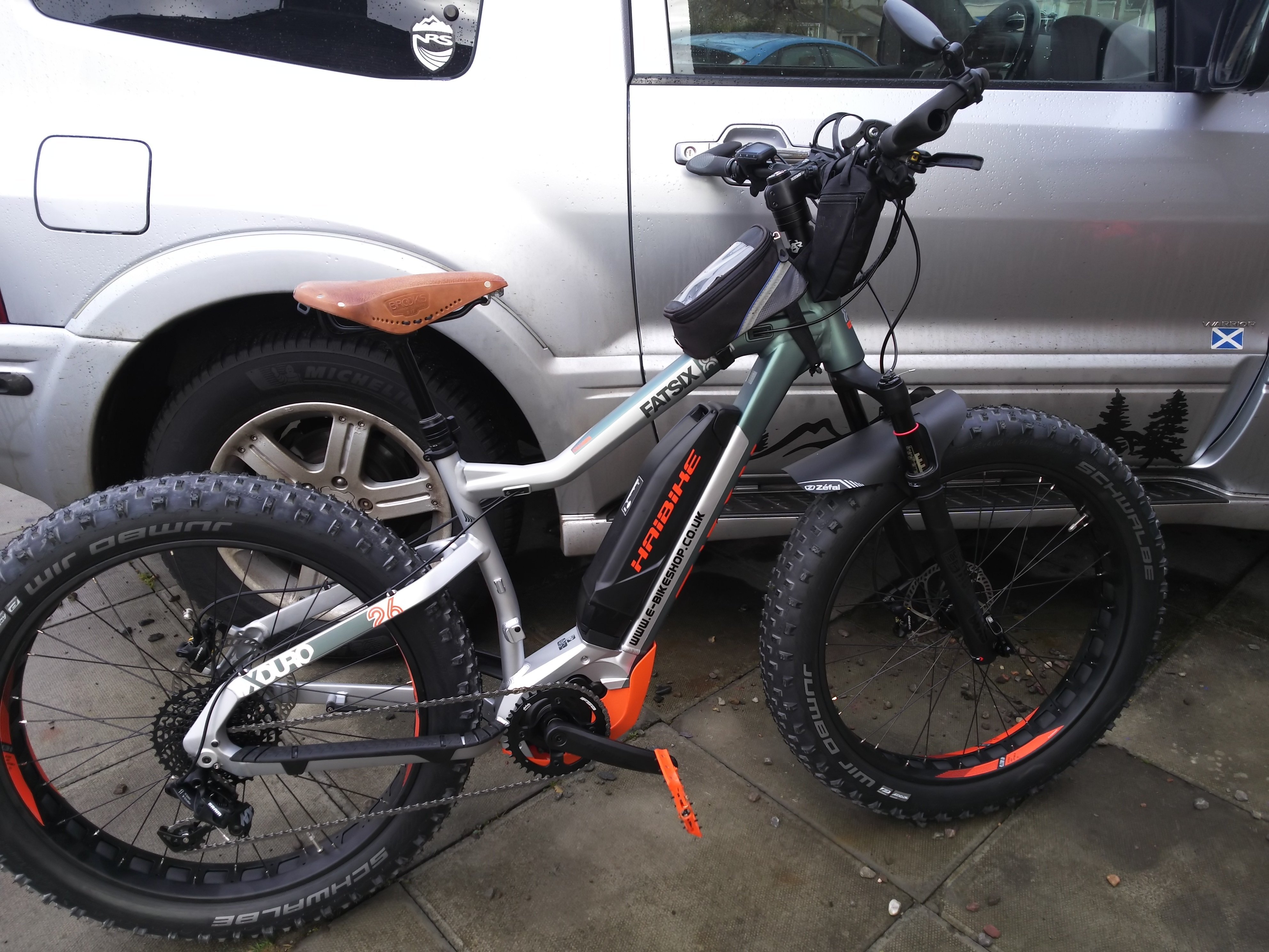

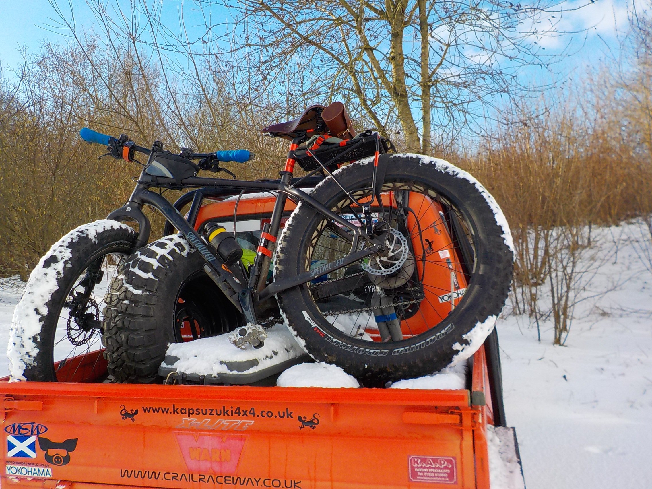

Re Fat Bikes of which i have a few and Plus tyre bikes and road bikes.
I might well run the 4.0 x 26 or 4.6 x 26 @ 5-10 PSI on Sand / Snow but still put them to 30 PSI for the road.
Same with the 2.8 or 3.0 x 27.5's maybe 15 psi for offroad and 35 PSI onroad.
As to road bikes the higher pressures are not due to lower volume, more to rim and tyre type and use.
I run cars of the same weight with maybe 15" wheels and higher profile tyres at the same pressures as i might when 17" wheels are on with lower profile tyres and the same circumference / rolling diameter.
Fat Bike and Michelin Cross Climates in 265/65 R 18. in the same picture.
 I run these CrossClimates at the same pressure as when the wheels have on 285/55 R 18 Tyres on.

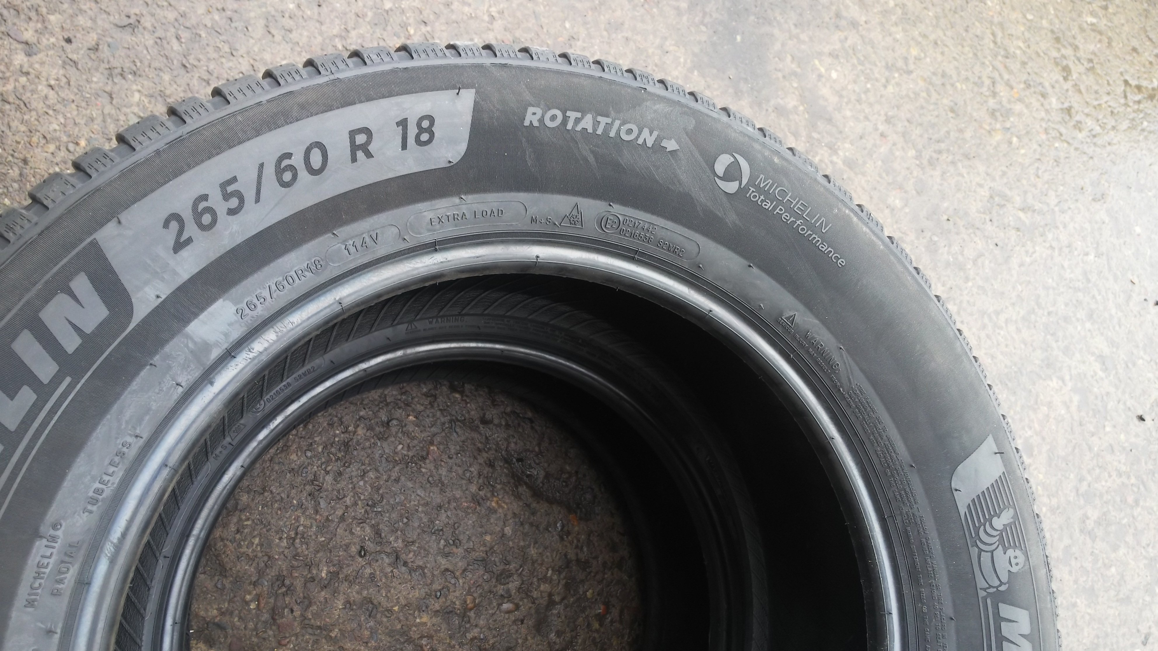

Much importance with  tyres and use and sidewalls, load and speed rating for a SUV.
XL / Reinforced, and Winter / All Weather, All Season & CrossClimates, Summer & Wet weather tyres.
You notice the difference in the sidewalls when fitting them.  Some are pretty pliable and some are not, and low profile that are not XL can easily damage as can
something like 'All Seasons from Maxxis like a AP2.
I have Cross Climate SUV's which are a different sidewall from other CrossClimates which i have also had on cars.
