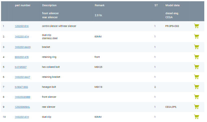

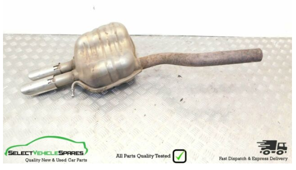

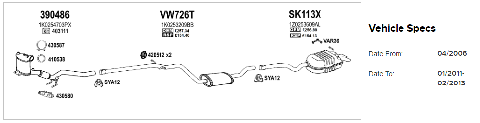

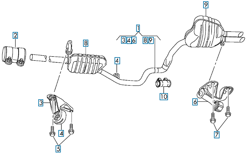

Have a look at miltec - resonated would be all the benefits of a standard sounding exhaust with the piece of mind that it won’t rot!
The part numbers you need are readily available from Euro Car Parts...
Middle Section: 1K0253209BB
Rear Section: 1K0253609AL
Googling those part numbers reveals the straight twin tail pipes confirming the vRS fitment...
thanks mate been on europarts and they don't have it only can seem to find gaskets - no exhaust
They have the part numbers on there, Skoda part numbers and what look to be their own, so it might be worth giving them a ring.
