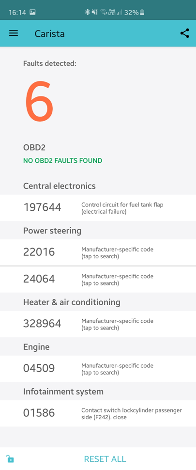

With full access you should see something similar to this...

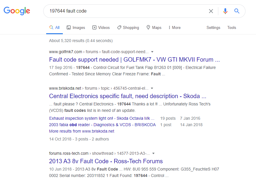

Then take the codes and pop them into Google and you'll usually get the answers you need...

Just got a new Superb IN L&K, and a CARISTA OBD, done a few adaptions but nothing really much use as the L&K seems to have almost everything useful.
HOWEVER - it has shown 14 fault codes most of which are full numeric and do not seem to exist on the internet.
What do SKODA dealers think about owners reporting faults at this level of detail, having to tell them how you know.
Is there any list of SKODA specific codes which is all the CARISTA is telling me.
