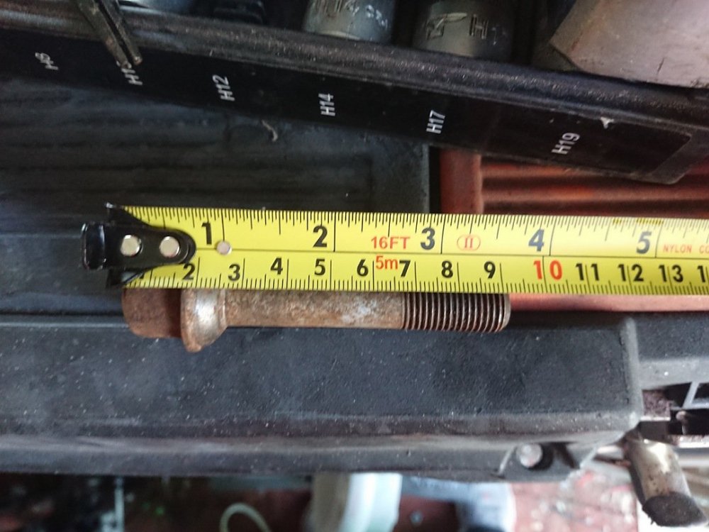

These are genuine original porsche 924 wheel bolts.
IMG_05052020_164843_(1080_x_810_pixel).thumb.jpg.adad1995222b45456e6011c397dfecd0.jpg
Not a problem so long as they are clamping 2 solid objects together with close tolerance clearance holes and one spigotted to the other.
Its a big problem when you have no spigotting and 2 intermediate spacers with huge gaps around the bolts.
I totally agree, and have never fitted wheel spacers to any of my cars because of how dangerous they are.
