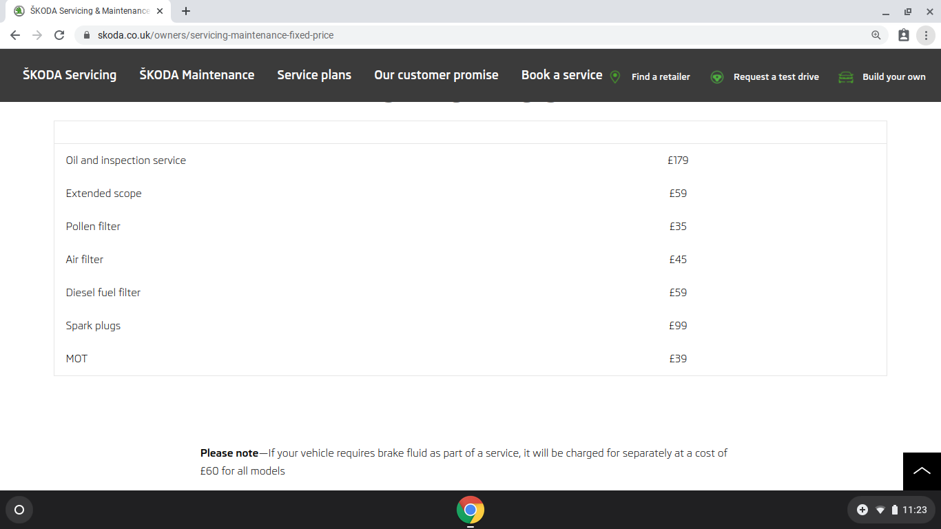

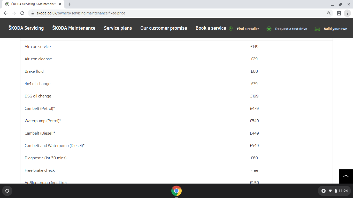

Shirley says,
She has seen plenty cases of a EPC or Exhaust Emissions light on because of misfires and no code for misfires stored or needing cleared.
£99
The price of supplying & changing plugs in the new Skoda UK Fixed Price Servicing Menu, 'At participating dealers that like good money for old rope.
(Some not participating dealerships might be cheaper.... But diubtfull.)
Shirley says 'Best see a friend and if they can change the plugs'.
3 hours ago, Roottootemblowinootsoot said:
