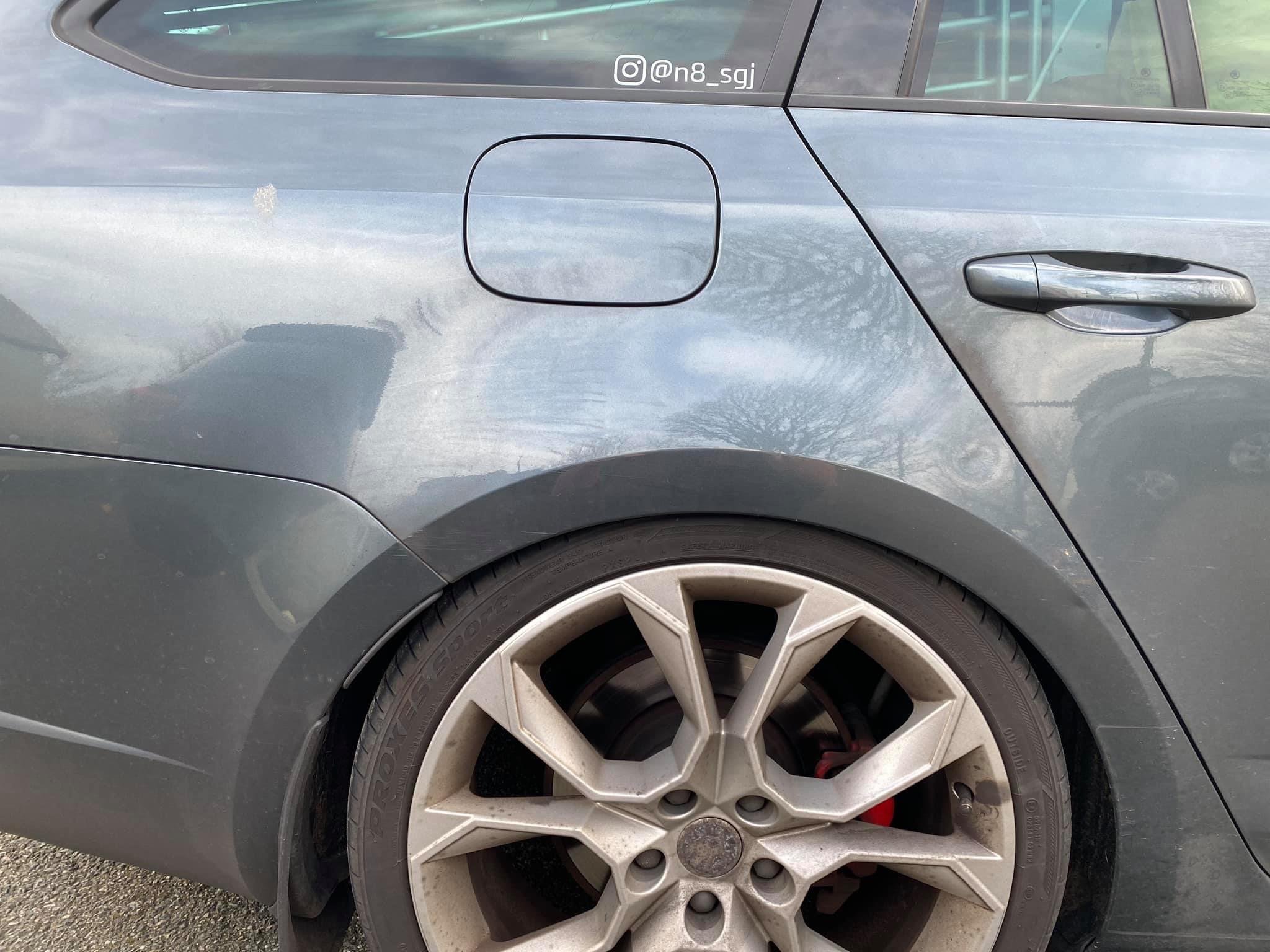

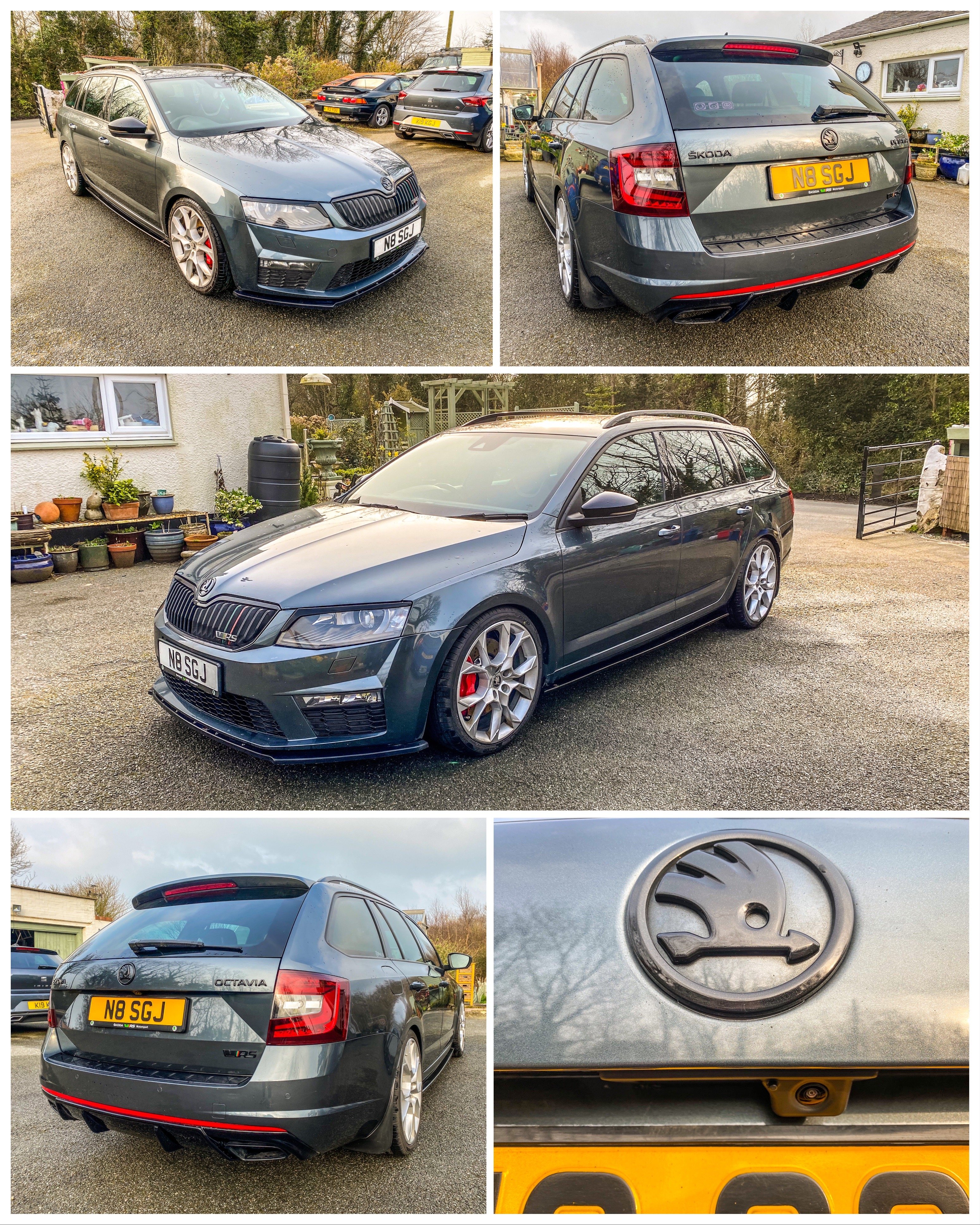

I had the spacers on first, wouldn’t go 20 front unless you want the wheels right on the limit. I had to for my brakes. I can have 2 adults in the back, a boot full of gear and a 5.5 meter rib on a trailer behind, no problems at all. I had a full alignment done afterward on a Hunter machine as I knew the tracking needed doing anyway.
Spacers came from Watfields engineering on eBay.
Please see below a loaded up picture and some everyday shots.
I also live in a rural area but if you pick the right line it’ll all be fine. I have the splitter to worry about as well!
